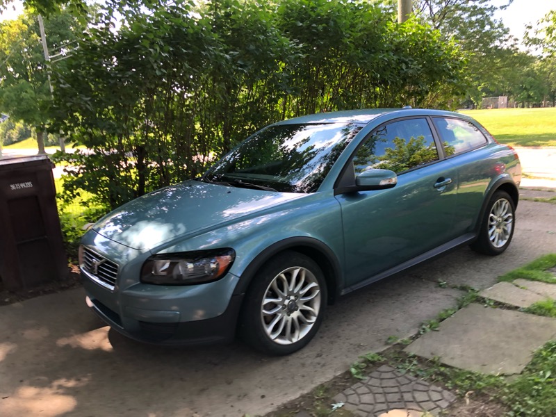

I finally found one! After much hemming and hawing over buying a brand new car (was mainly shopping the GTI/WRX range), I decided to reverse course and, rather than put a four offer sum down and have a car note, to put the same sum down and have...well, a car.<img src="http://www.vwvortex.com/Anthony/Smilies/biggrin.gif" border="0" alt="" title="Big Grin" class="inlineimg" /> Found a former Ford A-Plan car, 2008, 77K miles. It does need a pair of tires and a wheel bearing, but other than that looks to be in decent shape. Would love some advice in terms of things to look out for in the future, though.
Not planning on modding it, though that may change. I have always admired the sound the 5-cyl makes in the European MkII Focus STs, so I'd consider anything that would bring the acoustics close to those. Other than that, thinking of installing a CarPlay-supported head unit, so if anyone has any recommendations, I'd appreciate it.

very nice
does your car have a sunroof? doesnt look like it
It doesn't, and just as well, as I don't really like them
