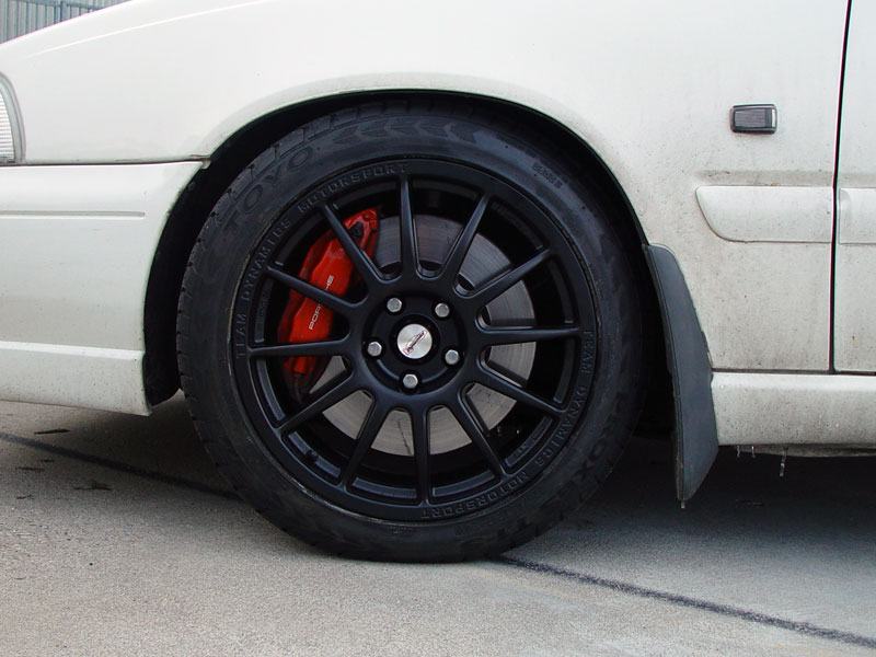

Fitted 17"x8J Team Dynamic ProRace 1.2 to my S70 today.
The front is using Porsche 993TT calipers and Volvo R rotors. This setup is a bit wider than the R's setup and the rims fit with plenty of room left. 1/2 an inch minimum on all sides.

So, how much did they wieght...
T1-S is kinda old school technology isn't it...
Good news that they are 17x8's though.
I have those rims on my Black STi the don't look good on a "R" imo

i had the t1's on last summer and was very happy with them. got about 14-15k miles out of them.
i looked at the 1.2 but went with a different rim in 18"
i'm trying to remember the weight. IIRC 21lbs
mike

So those rims are 21lbs? And the Pegs are 26?
Re: (24Hours)
According the manufacturer they are 19.8 per rim.
The reason I went for the T1-S is because they were available and at a good price. T1-R should perform a bit better.
