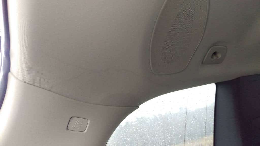

I have a 2016 XC90 Momentum. We purchased it Certified Pre-owned in October 2017 with 29,000 miles on it. It now has 42,500 miles.
I searched and found many threads on leaks from the sunroof, drain pipe etc. So obviously leaks are a known issue despite the customer service rep sounding surprised when I called.
Today when I opened my trunk at the end of the work day I found water dripping from the pillar in the third row on the drivers side. The trunk mat (plastic) was filled with water, the carpet on the side wall and in the cubby was drenched, and the ceiling had rings of water. The water was dripping through the 3rd row seatbelt opening as well.
I am taking it in tomorrow afternoon for them to "look at it" and "see if they can find a problem". My questions are what can I reasonably expect from the dealership? I do expect the fabric on the roof replaced because that is obviously stained.
I am worried about the carpet of the cubby and sidewall. My daughters water bottle leaked in my old car and I felt like I could never fully get rid of the mildew smell. Will they replace the carpet?
There is obviously water in the 3rd row seatbelt mechanism. With all the sensors do I need to be concerned the water will affect them? The safety of the 3rd row was a very big part of why we bought this car as we use it frequently with carpooling and sports. Can I ask them to replace the seatbelt mechanics?
The stain is currently not at, but spreading to the speaker in the ceiling. Could this affect the speaker?
For those who have had to have repairs due to a leak, how long does it usually take? Our closest dealership is 35 minutes from home, an hour and 15 from work. I'm not sure that they provide loaner vehicles and I think they only have a shuttle to the local shopping center. I really can't be without a vehicle and don't want to spend hours in the dealership with my 12 & 7 year olds.
Thank you in advance for any advice!

There is a bulletin for an updated seal kit for the sunroof cassette. This will likely need to be installed, as well as leak checking the cassette itself.
The headliner might be able to be cleaned. If it can, warranty covers it. If not, replacement is also covered.
The speaker will be fine, it is located in the roof, not in the headliner.
The seatbelt will be fine too, but they can clean out the connector when the panel is off (it comes off to drop the headliner).
The carpeted panel won't likely be replaced but I wouldn't expect any odors. The carpet there isn't exactly plush and absorbant by any means.

I noticed water in the exact same place on the pillar as pictured above, but on the passenger side. I've had my car for 2 years now and never noticed it before. I think if it leaked before I would have seen it because I use the back of my car everyday for my dogs. I was parked facing up an incline. I thought the water was from opening the hatch and it pored in as the hatch opened. It seemed like a lot of water as the plastic storage bin had a noticeable amount of water in it. I've been watching it ever since. After reading this post I'm thinking mine is leaking too. Luckily I took pictures of it that I can show the dealer.
#17 ·
Being parked up on an incline would cause it with the old seals. The seals go between the back of the sunroof tray and the body of the car. The old ones didn't properly seal, allowing water to overfill the tray and get onto the headliner. The new ones seal it better so the water is directed to the drains. So you probably need the updated ones as well.
