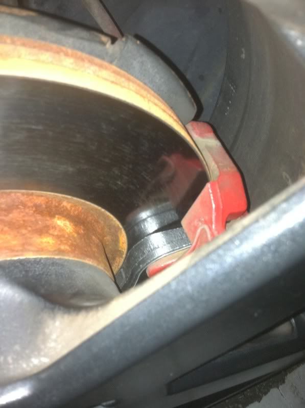

I reciently installed new brakes on my s40 2.4i and now there is a constant screech and whine while I drive. It continues even when I apply my brakes. I alligned everything up and thought I did everything correctly but apparently something is wrong. I took pics of my rotor and brakes and it looks like the brake pad is partially engaged? Maybe they gave me the wrong brake pads?
lemme know what you think

Those look like factory pads. The chamfer on each end of the pad is totally normal. It sounds like you have the brake shield (thin tin plate behind rotor) rubbing the rotor. It's very common on the S40 (tight clearance). You may have caught the shield when pulling the wheel off for example. Take the wheel off & turn hub by hand. Bend the shield around until noise goes away.

Bend the shield inboard a little.

found out what it was, on lunch I pulled back that shield and a big ole rock came out of it. It had been worn down so I am sure that was the problem. thank goodness!

I'd say most likely the shield got bent during install and likely requires a slight tweak, pretty common.
