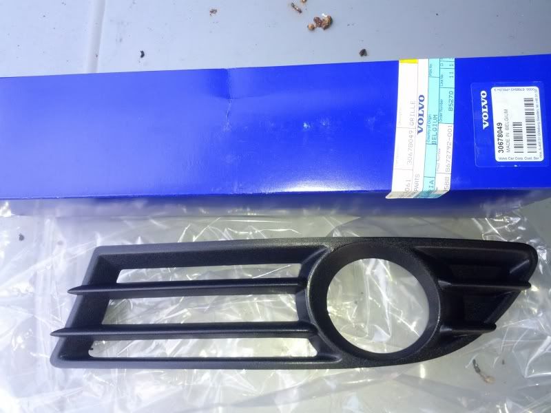

I picked up a timing belt kit which had the wrong tensioner. I brought it in to swap it out when I was picking up a fog light grill. I got home and went to put it on the car and its also incorrect.Seems to be the right size and all bit doesn't match the original. Only difference being new is slotted.and the old one is solid. Is the one I picked up the newer style ?
What's on my car(don't mind the dirt)
What I got
What I got
OH - you got the better, cooler looking version. Some of us spent an hour using an X-acto knife cutting out that same areas....

Any one have. Picture of these grills on their car?
And is there a.way of getting the old one off without removing anything else ? I imagine it just a matter of disengaging the tabs that hold it in place?
Read the how to on IPD's website for their ram intake and yes plenty of people run these fog grills.
