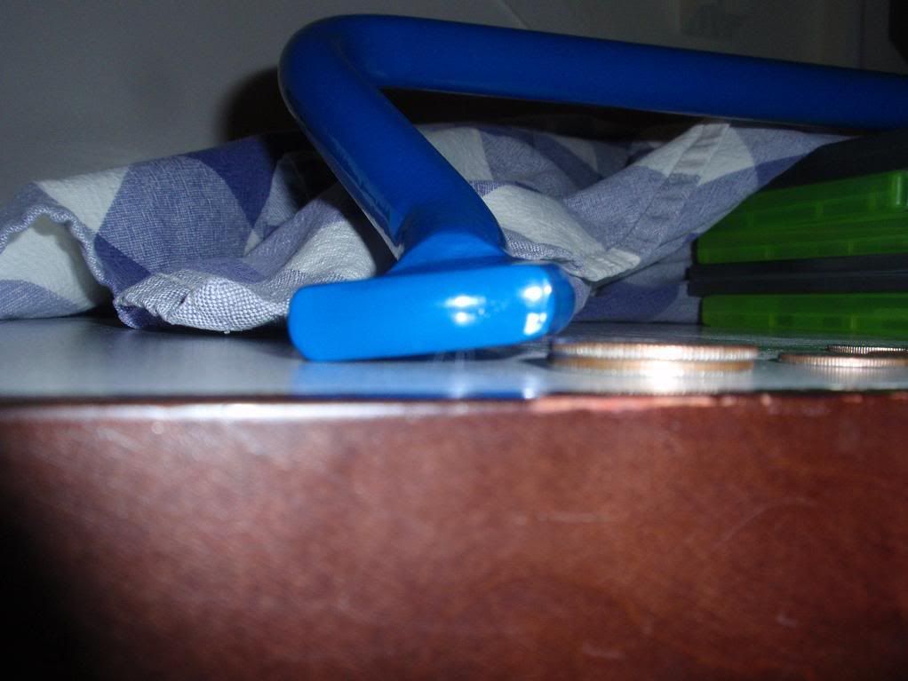

Well I installed my bar the other day and it was a PITA. I checked out the C30world thread about this and it looks like my has a problem. The forge ends seem to be bent too up which causes the bushing to be really off. They should be flat with the bar itself. What do you guys think?

hmm...just snapped some pics in the dark and need some opinions. The angle isn't as bad as vash's but there is some angle. Hard to see in my cruddy pics. Should I be concerned?

In some of the pictures it looks border line returnable. Give Robert a call he will help you out. The bushings don't look as off as mine.
Re: (Vash13)
It's supposed to be bent up like that. It looks live you've got your bushings way to tight, that's why they didn't look right.
Not only that, but they won't seat right away, they will be slightly off center. After driving for a little bit, they will settle in place.

I've added to the flood - my ends don't quite match each other. I e-mailed ipd some pictures and I'll let you know what they say about these:

I think that looks pretty good. I don't think it has to be 100% flush with the bar. I wouldn't be complaining with the bar you have right now
. I think the problem with having such an off angle like mine could result in the bushings to rip off at one end because of the uneven pressure later in the future.

I think mine is similar to Vash's...which could explain why it was such a b***h to put on. I will take another look at it tomorrow and snap some pics. I really like IPDs customer service so far, it looks like maybe they got a bad batch of bars though...
Wow...I thought it was just me thinking it wasn't supposed to look like that. Mine looks exactly the same. Almost would just deal with it so I don't have to take it off again and redo it.
Re: (Vash13)
The slight angles here aren't any cause for concern. The suspension moves quite a bit depending on the ground and the load, so the angle is all over the place. It's even possible that the slight cant will help.
The first one was clearly defective. If yours looks like that, call.

Look 7 posts up for the pictures I sent to IPD. Upon seeing them, Bud said he's shipping me a new bar. Mine was pretty close to the spec from what he said over on C30 world, but still out of it.
