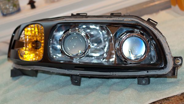

Now that I have a spare pair of headlamp assemblies kicking around, I am experimenting with a quad Xenon setup. Looks like the inner projectors need to be a little smaller though, these fit but it is very close.
Anyone know of a smaller projector than the morimoto mini?
front mock up mount

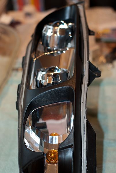

side mock up mount

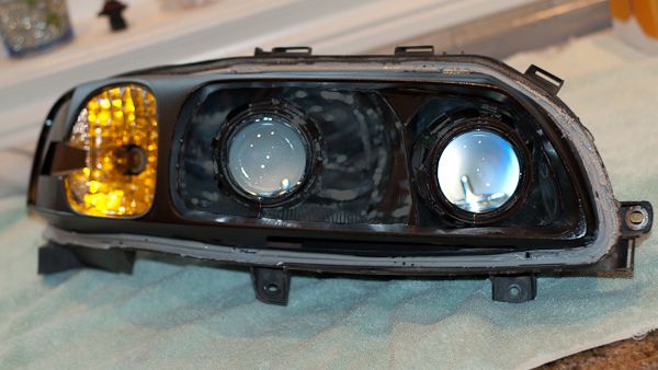

photoshop of darker shrouds

Rob, try the Bosch 1.5" lens Projectors. They are fog lights, but I'm sure it'll work fine as a high beam
you can also try Blazors Projector Fogs which are 2" lens.
8,700 Posts
oh and the older 350z projector housings, not true projectors but tiny!

Thanks Alfred. I found a set of 48mm projectors locally, now I just need to figure out how to make the shrouds blend better, the smaller one is a different style.
