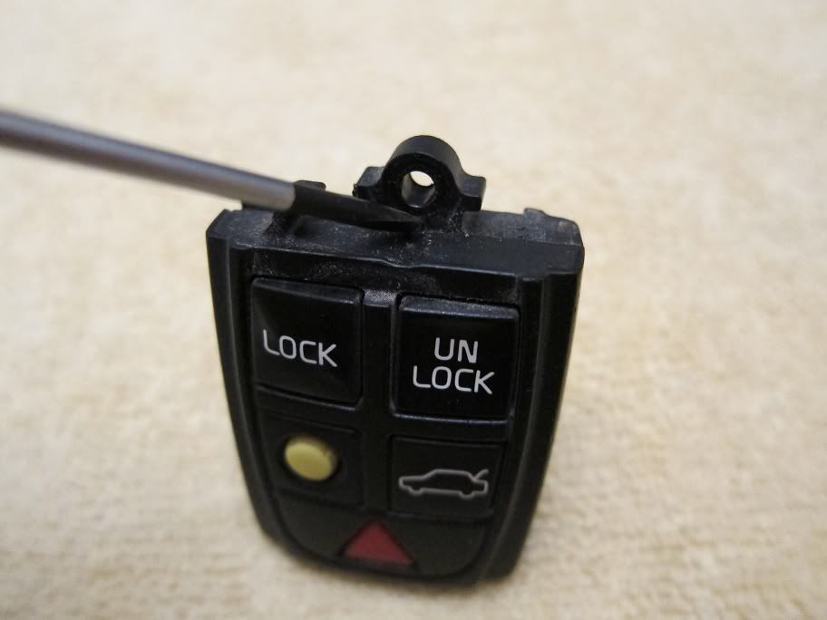

Remote is not glued, so this part is easy. Use small flat screwdriver to take the remote apart:
This is where we use that Ebay key to get rid of that small metal key ring. You can replace every part of the remote except the board. Use your old board that is programed to unlock your car.
Put the remote back together and when the epoxy is dry, reassemble the key.

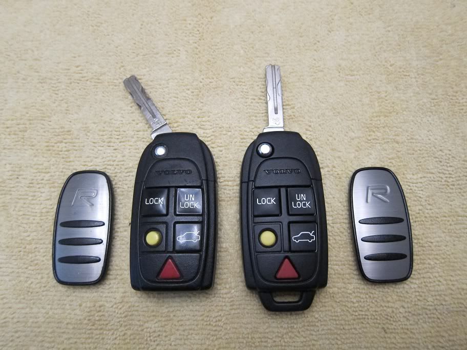

Here it is:
Left: old, used up key...... and Right: new and improved :)
Total for my "new" and improved key: $92
