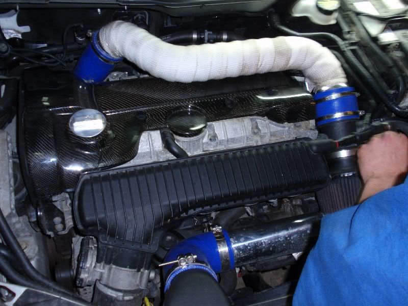

We also powerwrapped the intake pipe and the downpipe so there will be some pics and info on that as well.

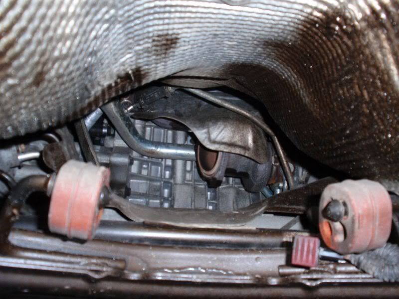

The stock downpipe:
Remove the engine shield. My buddy Rocksteady working on it here:

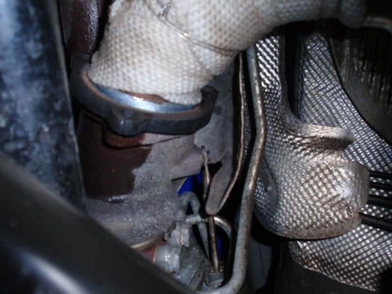

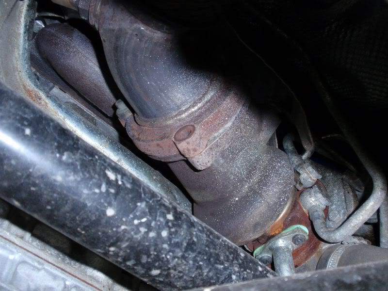

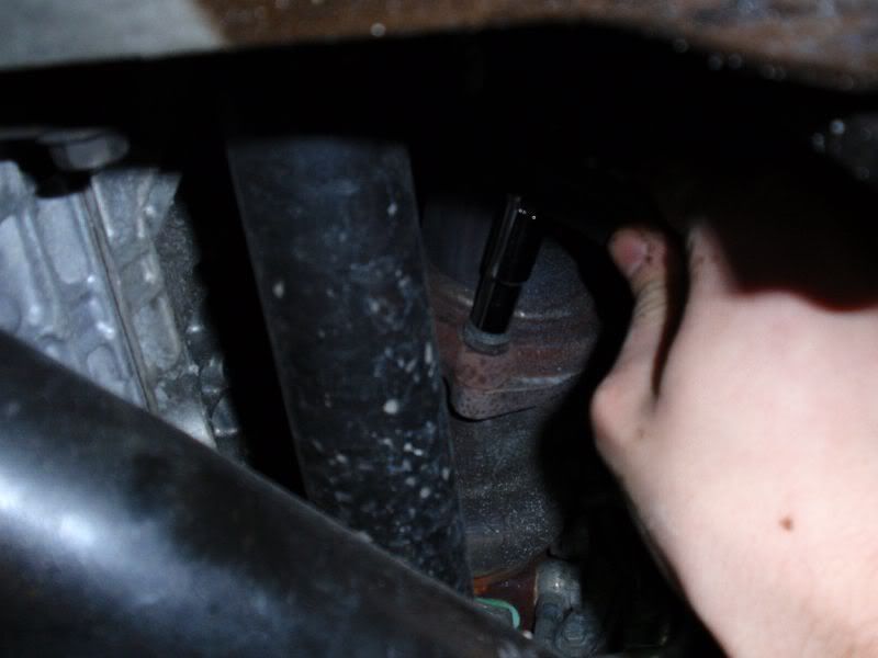

Once the plastic stuff is out of the way remove the bolts connecting the dp to the turbo:
This is a bitch so give it some WD-40 or something like it. Continue doing this!
It's a tight fit and it will not get better when the 3" dp is in place.

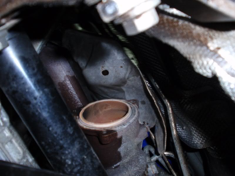

The dp is off:

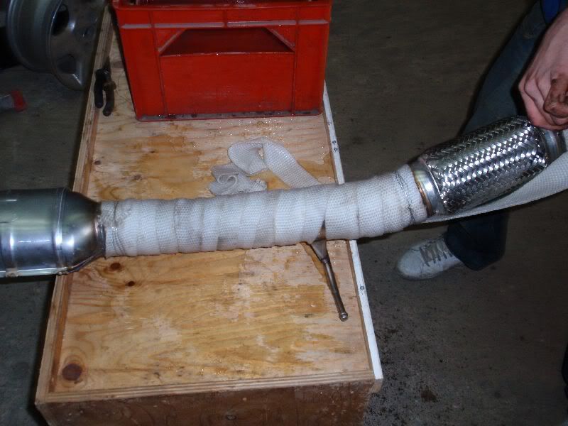

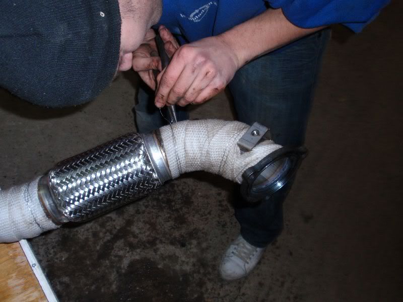

Skip this if you don't have any powerwrap or just think it's silly
Parts ready to be powerwrapped:
Do a trial run. The powerwrap should overlap it self and be strapped tight around the item. Cut the needed size.

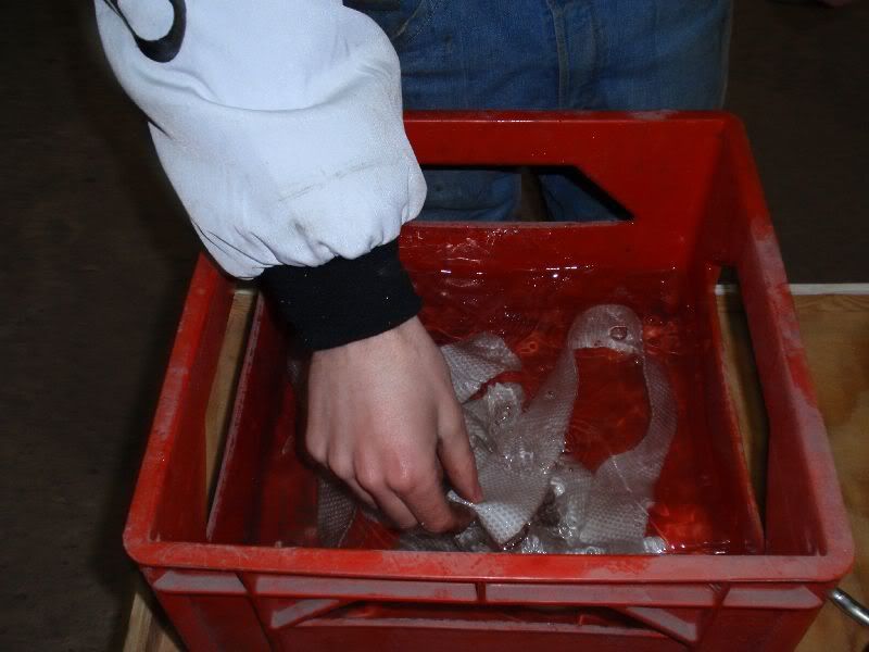

Soak the powerwrap in water and have some wire ready to tighten it at the starting and ending point.
The Sexy Dane and his Volvo jacket
Put the powerwrap in the water and leave it for a small time. Have a smoke or something.

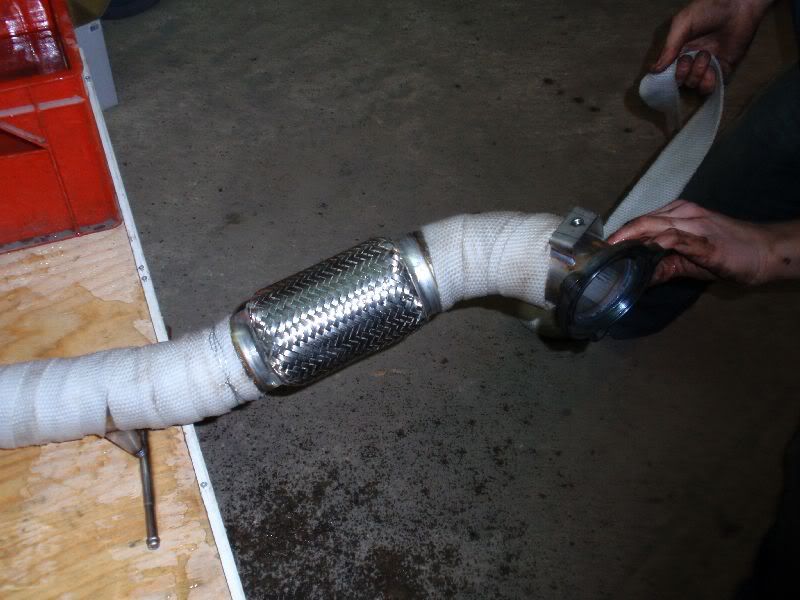

We forgot to take pictures of the first process:

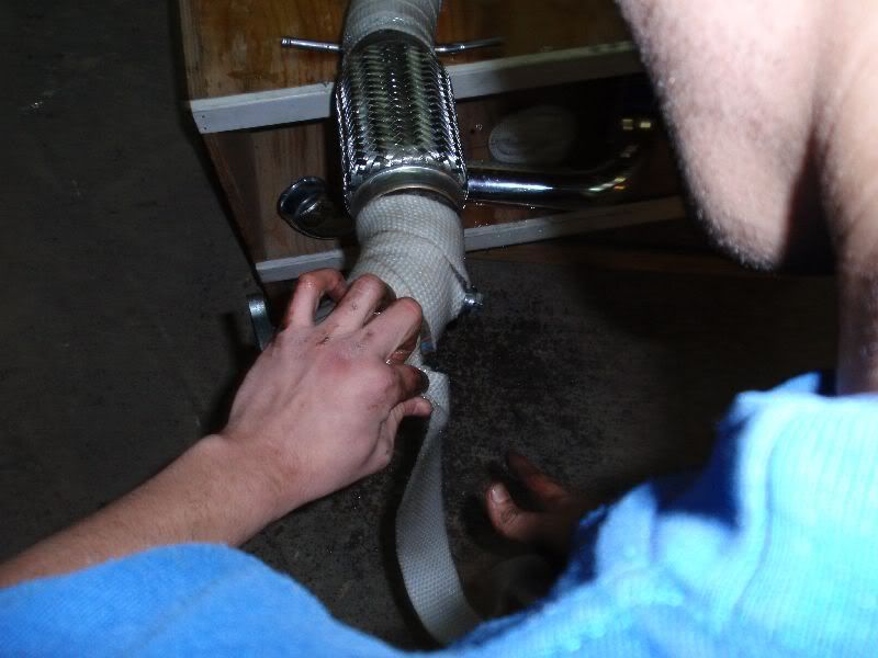

But we did the second time. It is adviced to have a friend help you with this.

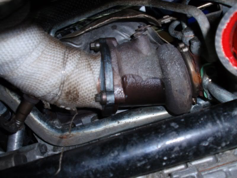

Remeber to overlap otherwise there will be "holes" between the wrap and that sucks.
Over the shoulder view:
Tighten it with wire so that it won't unwrap it self. If you did it tight enough it should stick but do it anyway just to be safe.
Let it sit and dry for some time.

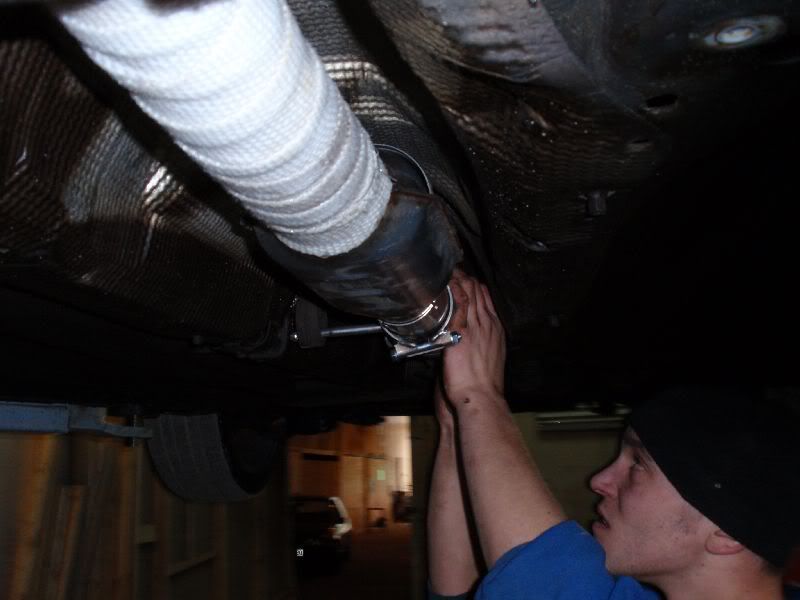

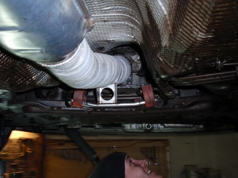

Put the downpipe in place:
Take the to bolts and place them so you don't have to stand there holding it:
Fit the bolts. If you have trouble with this have your friend push the dp forward as this makes it easier:
The bolts are fitted. Happiness!

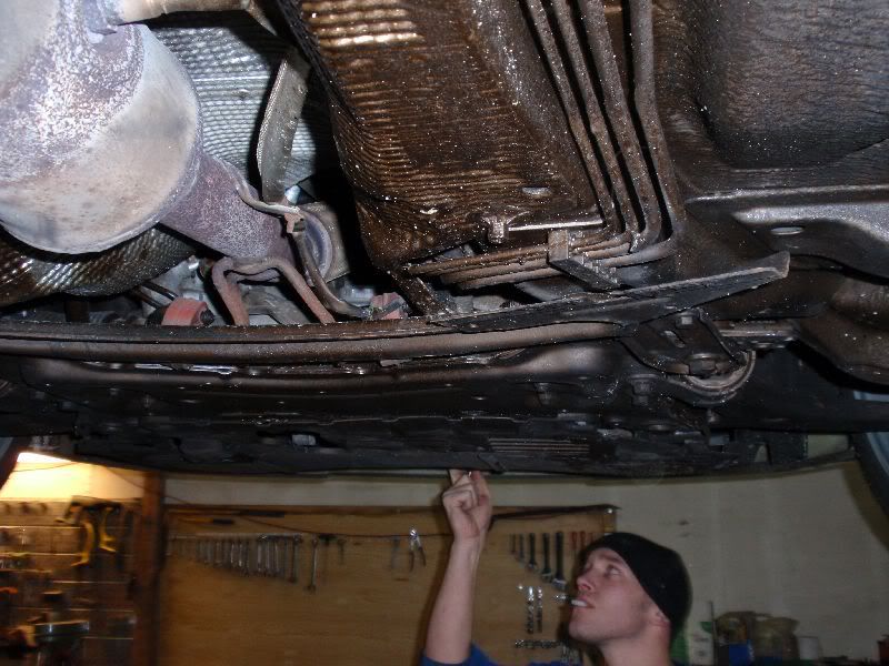

We removed the IC pipe to free up some space. Two bolts. Quick and easy.

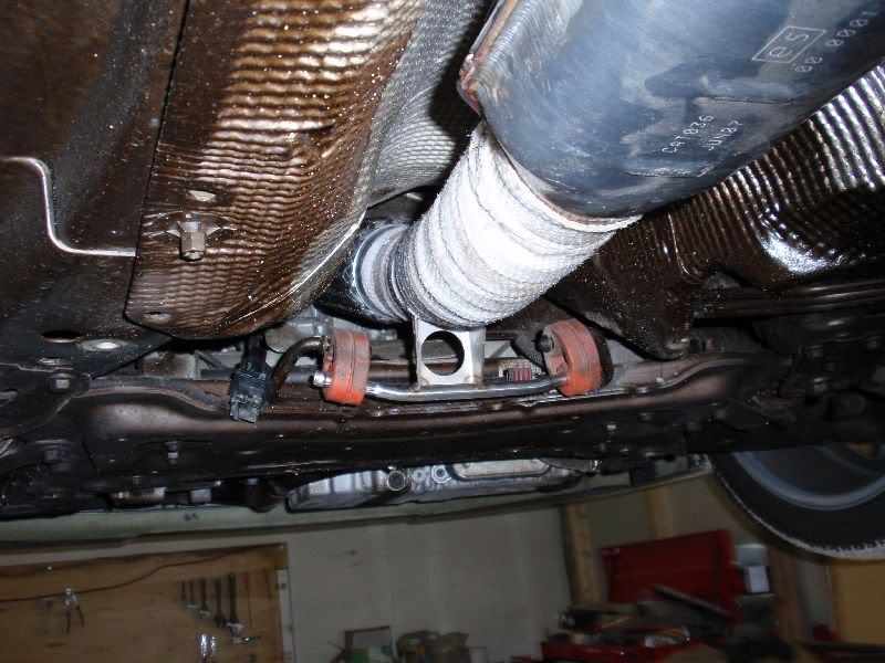

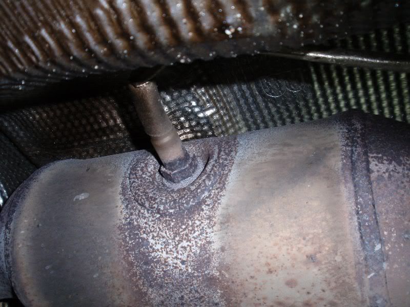

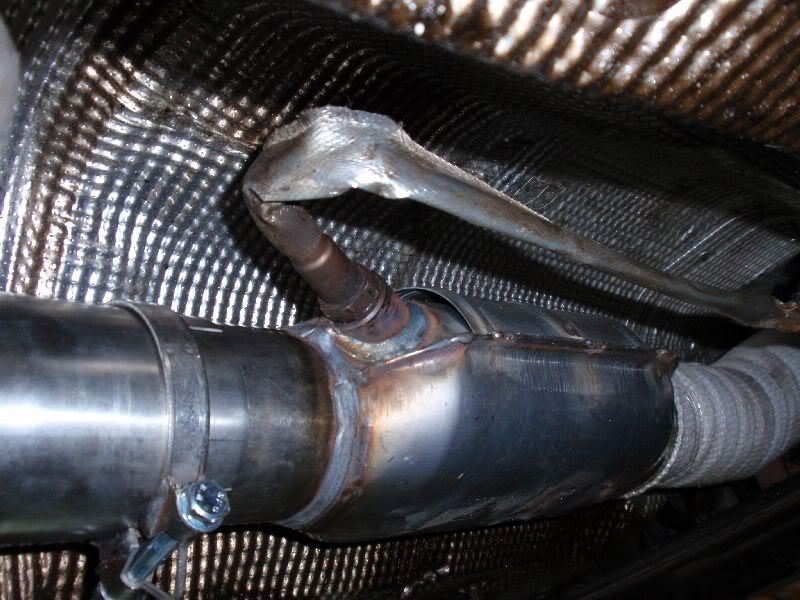

Take the first lamda piece and mount it on the dp near the turbo. No pics of this. Sorry.

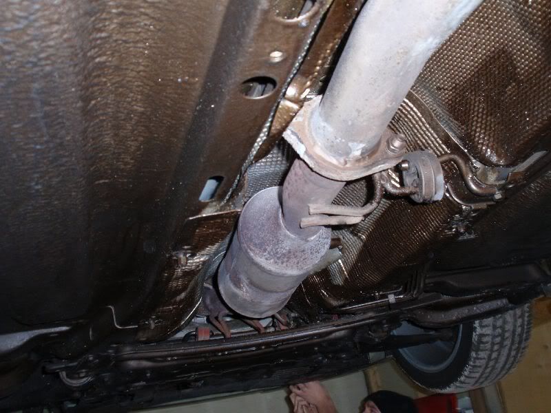

Take out the second lamda piece and mount it on the cat:

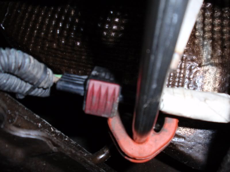

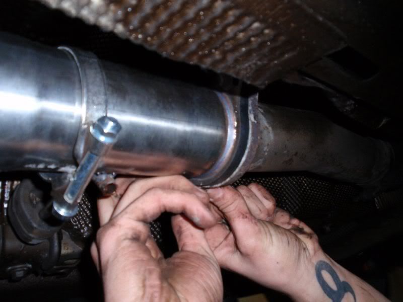

Mount the wires:
Tighten everything and put the engine shield back on. Done!

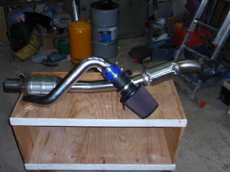

Now we will powerwrap some more poop.
Same procedure as last time miss Sophie!
Looking good!

Increases exhaust velocity by maintaining temperature through the downpipe, turbo will spool faster as a result of less backpressure(due to higher temp in the downpipe farther back). Intake side, shields from engine bay heat contaminating the intake charge, may or may not help since thats atmo in the top pipe. wrapping the piping from the IC to the TB may be more beneficial, but could also hurt performance, this is something that needs to be dyno tested to see what works and what doesnt.
Also, a word of caution, keep any eye on your downpipe, it won't last long with that wrap if it gets wet.
