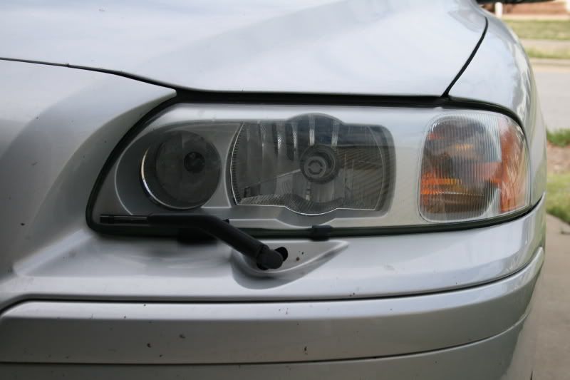

Here's my DRL delete
2
Re: (MightyQ)
Quote, originally posted by MightyQ »
any close up's by any chance?
2
Re: (QnsMostWanted)
I have at least one pair of them
I figured you'd have another by now!
I have my S60r Headlight apart right now on the floor.
It is frosted definatly.
If anyone needs excact pics let me know.
