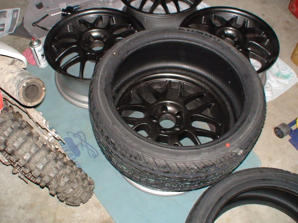

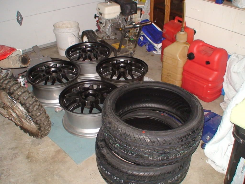

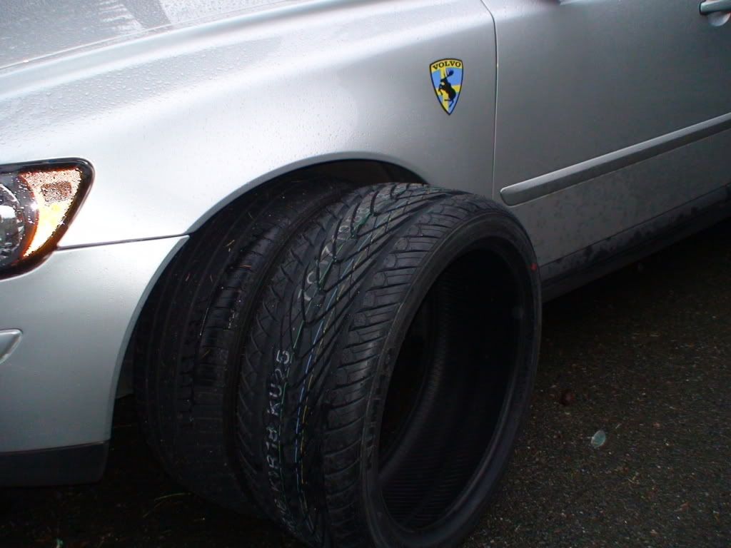

Alot more low profile than I thought haha
Nervous that since they are ultra high performance, that I may have to get new ones too soon...
But here they are!
I'll post pics of when they are mounted and installed!
