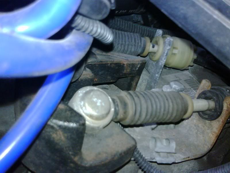

I ask for help! My cable of an old sample, I can't find number OE in any way
Maybe who bought to himself an original set, give number please
I don't want to change the lever under a new sample and to put new a cable. The cable as on a photo is necessary

I found a number of cable 2003-2004 model year, the number of cable as in the photo - 30614453

As someone who is installing a 07 transmission into my 04, I thought some of you considering changing out cables or transmissions would appreciate knowing that there is no need to change out the entire shift arm on the transmission. You can just change the nub on the arm since they are screwed into the arm and the arms appear identical.
