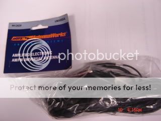

Antenna delete plug w/ hideaway antenna

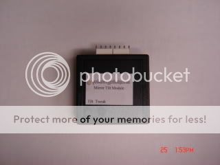

Auto tilt module for parallel parking

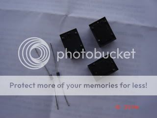

Built a relay pack for radio and Ipod to stay on till door is opened

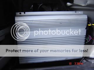

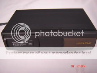

Added additional factory amplifier for bridged operation. Increases power from 4x100 to 4x320 according to Alpine's specs from the MRV-F400S. Make DIN adapter, and run new power wire to battery for install. Amplifier can be mounted on factory bracket if changer brackets are removed. Will upgrade the amp to the center channel when I find one I like. No other wiring other than a short ground wire is necessary.

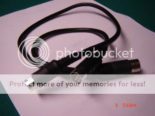

converted antenna down switch to access between cd changer and Ipod.

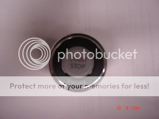

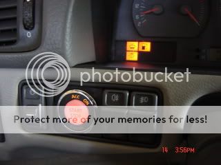

Finished more prewiring, not done, but bench tested functional. This will allow for start/shutdown with a single button. Key can still be used, but unnecessary.
Update: 6/09/09, fired it up in the coupe, system works as it should, only time will tell if their are any quirky bugs in the setup.
Temporary location, Key position 0, Lock LED lit
Position II, Key sense, Ign, and both Acc wires energized, engine not running

1. how does "Auto tilt module for parallel parking" work? could you please explain in detail
2. how did you get the thing for the radio and how does that hook up ?

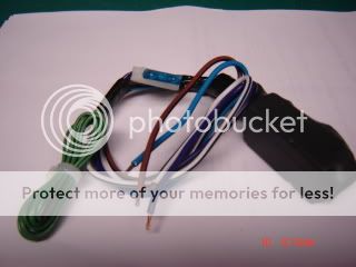

1. Module can be setup to tilt mirror in reverse. I chose to go with programming option 2 and set it up for double pulse tilt. This means that I shift into reverse, neutral, reverse the mirror tilts. Take it out of reverse and several seconds later it goes it the normal position. My overall opinion of mod after several weeks is fantastic.
2. Made the relay pack. You need 3 relays and 2 one amp or greater diodes. Wiring diagram is located on http://www.the12volt.com if you want to make one yourself. I also have several premade that can be purchased for 30 shipped US, and 35$ outside. Pretested with instructions included.
3. Memory module that goes back to last setting before ignition is turned off. So if your traction control was off, then it will automatically turn off when car is started. If it was on, then of course it will stay on. Module can be use for a variety of applications.
Both the mirror tilt and memory module can be purchased through kptechnologies. I bought some rebranded modules from a reseller for a few dollars less. I have more mods in the works, but wanted to share what has been done so far. Instructions on any of my mods are available so adding them to your car is a walk in the park.

are the relay packs plug and play or do you need to splice into factory wiring(or into the aftermarket wiring harness)?
440 Posts
Re: (db130)
I soldered my connections behind the radio, and one wire out of the door harness for the driver's door trigger. These of course could be crimp capped or quick connects, but I am old school and like to solder. Should take a person 15 minutes to install.

Where did you get the Antenna delete plug w/ hideaway antenna from?
440 Posts
Discussion Starter · #16 ·
Re: Few Recent Mods (adale)
Made the plug, then painted it with Volvo spray paint to match. I was very surprised that the color matched so well. Antenna is from Amazon.
