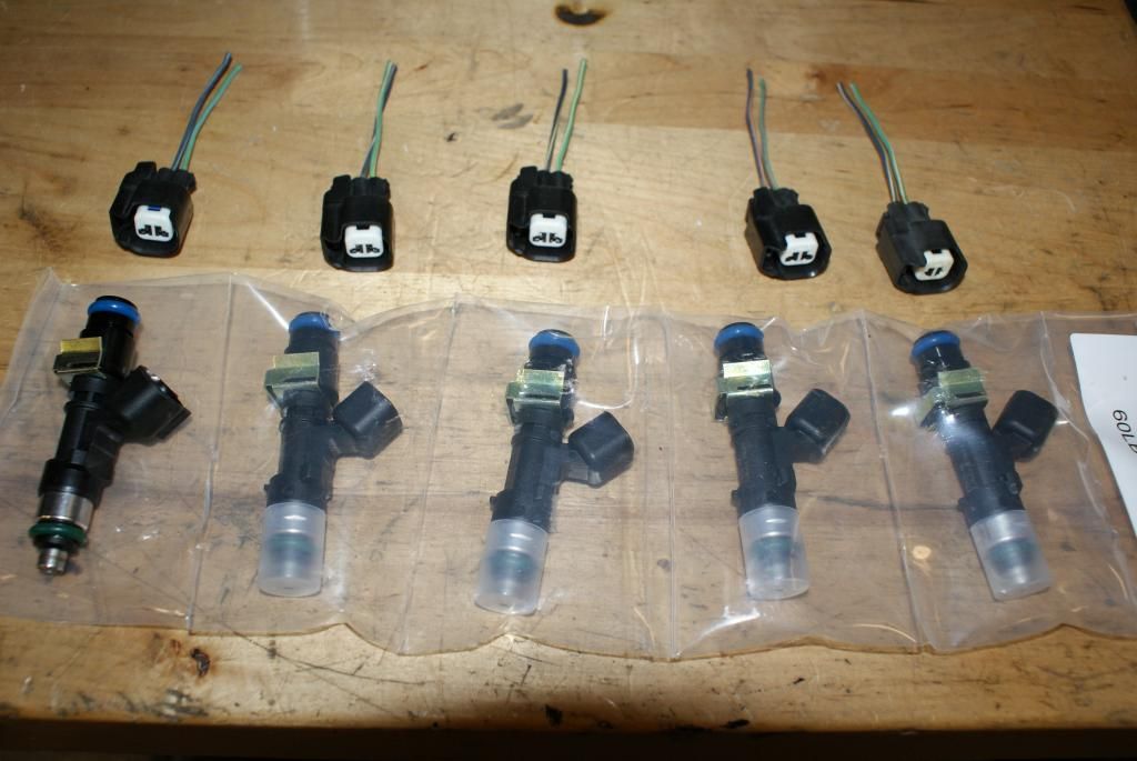

Ford uses the 14's for better emmisions and better mpg's and they do not tick like ev1's and they idle and work like a dream.

from what i heard 4 spray hole injectors are like dinosaurs...whats not satisfying to you, that they are new generation and they spray out almost like vaporized mist?
I've had modded 750cc EV14s and have heard multiple vehicles with factory low flow (<750cc) EV14s: They are not by any stretch of the imagination quiet. They're about average for a modern injector.
I can say, they are pretty easy to tune, but it helps a lot to have accurate data to start with.
Good choice on getting a similar spray pattern dougy. That'll go far in making sure your tau isn't far off. The angle is a little wide, 20* vs 15*, but its a lot better than standard cone pattern.

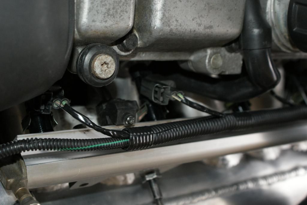

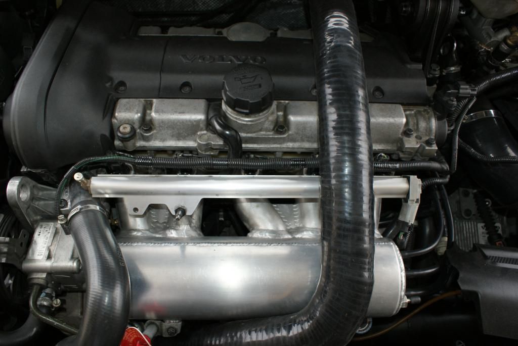

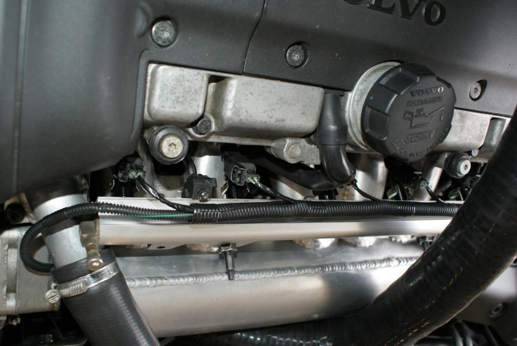

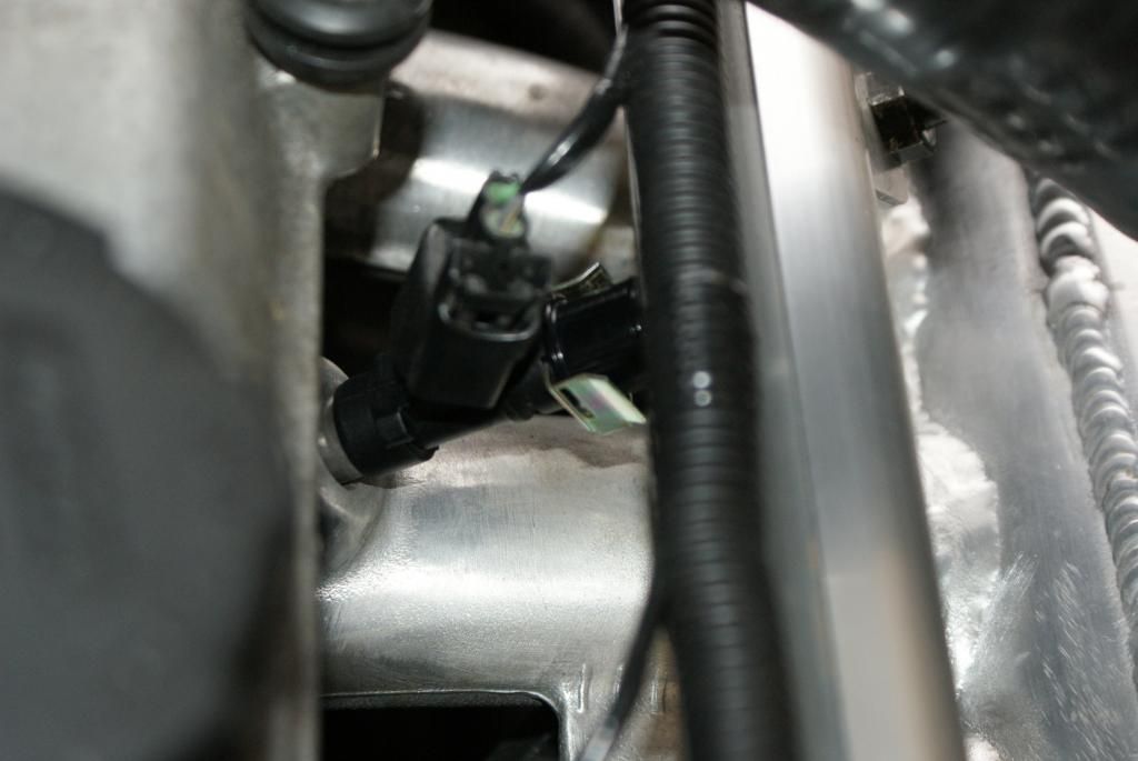

they should but send him a link to this thread , that way he sends you the EXACT length extenders as you see in these pics, so you can lock them into your fuel rail correctly.
