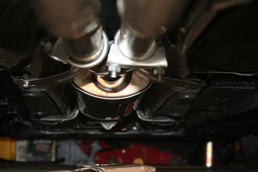

Additinally the Volvo tech shimmed the rear dual-pipe hanger brackets with about 1/2" of washers. The whole system was hanging really low and the rubber hangers were stretched to the max. In this picuture I had removed the shimms but it was still too low for my liking:
The Volvo road tested it and probably thought what a piece of junk and probably said to himself "just another crappy aftermarket exhaust system". When he turned it over to me, he and the assist. service manager explained they were concenred the fit was bad and that they had to do extra work to keep it away from the drive shaft, they were pleasant and said not to worry that I can always put the stock cat-back on. I was just happy to have the DP on and figured I could adjust the cat-back at home myself and got out of the excited to drive it.
When I drove away, the thing sounded and felt really loud. My cup holded and verious other interiors parts virbrated like crazy. My initial thoughts were that I had make a mistake and that I'd hate the new exhaust system. Little did I know it was louder insiade the car than outside the car, yes, that was crazy!
At home later that day I was able to get a slightly better fit but still had the bad vibrations due to the metal-on-metal of the upsidedown bracket tightly wedged against the outlet pipe of the resonator. I removed it but then the drive shaft rubbed (what a crazy sound that makes!).

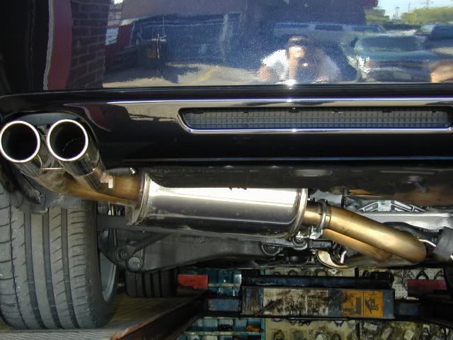

Knowing I couldn't fix this in my garage lying under my R I started searching for a good performance muffler shop and came across these guys: http://www.noyzboyz.com. I called them up and and explained my problem and owner Sav Mitas was very friendly and sloted me in for 8am the next morning.
Sav and his tech Steve sized up the cat-back and agreed the simple plan would be to remove the resonator and re-install it seem up. Steve got the dual-pipes red-hot but could still not separate them so they went to plan B. They cut the 3" resonator outlet pipe, bulged it and slipped it back over the cut pipe just before the Y into the duals. Doing so allowed them to line up the whole system from the DP flex right to the muffler to get the best possible fit. We left about 1" of clearance to to the drive shaft and 3/4" to the drivers side of the haldex and the duals are now nice and snug to the rear end before the bend up to the meet the muffler. Steve finished it off with some really sweet TIG welding around the 3" joint and around the joints at the duals (no more clamps and leaky joints!).
The rubber hangers are no longer overstreched and there was no need to use the safety brack upsidedown to keep the system clear of the drive shaft.
