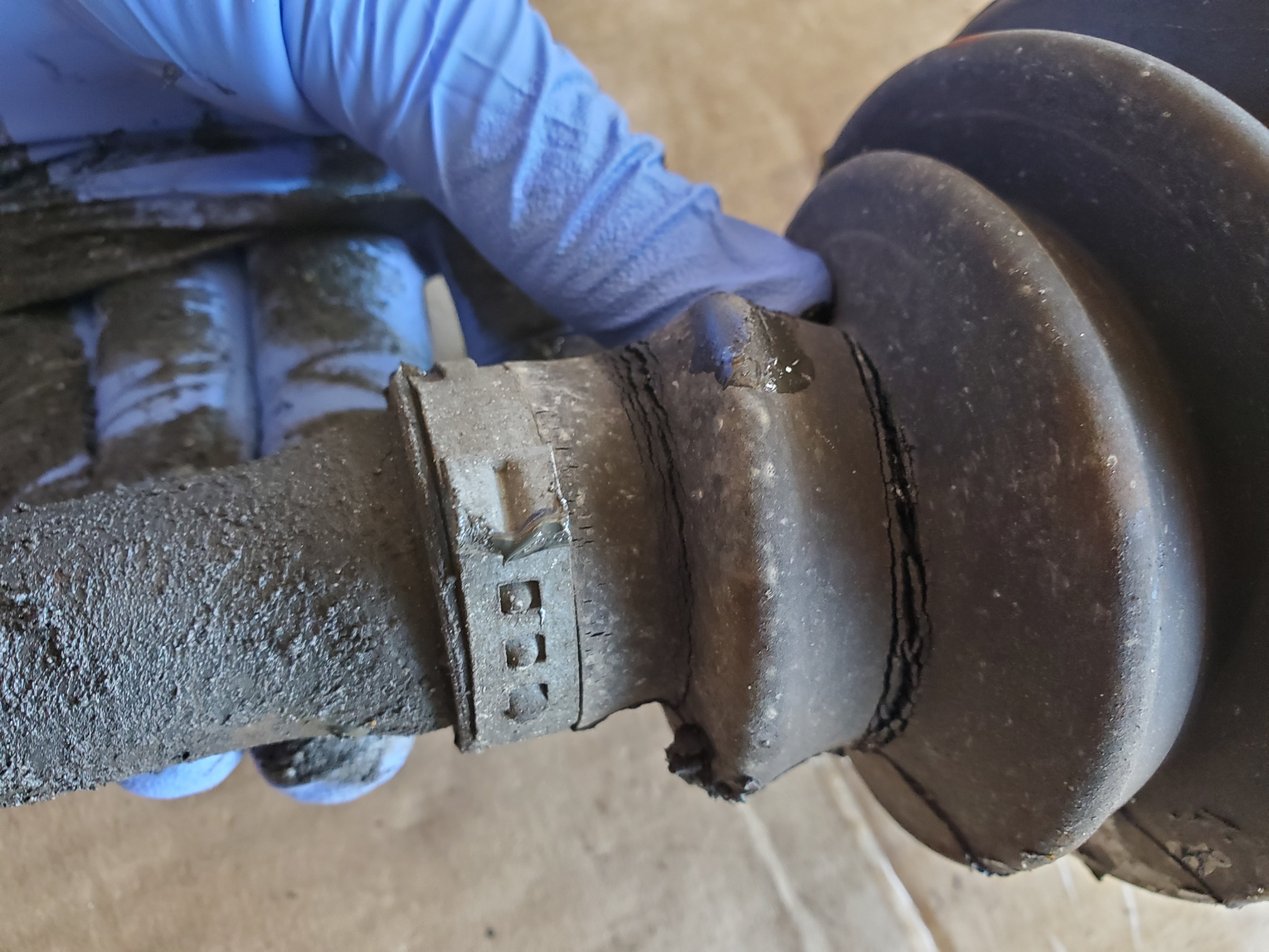

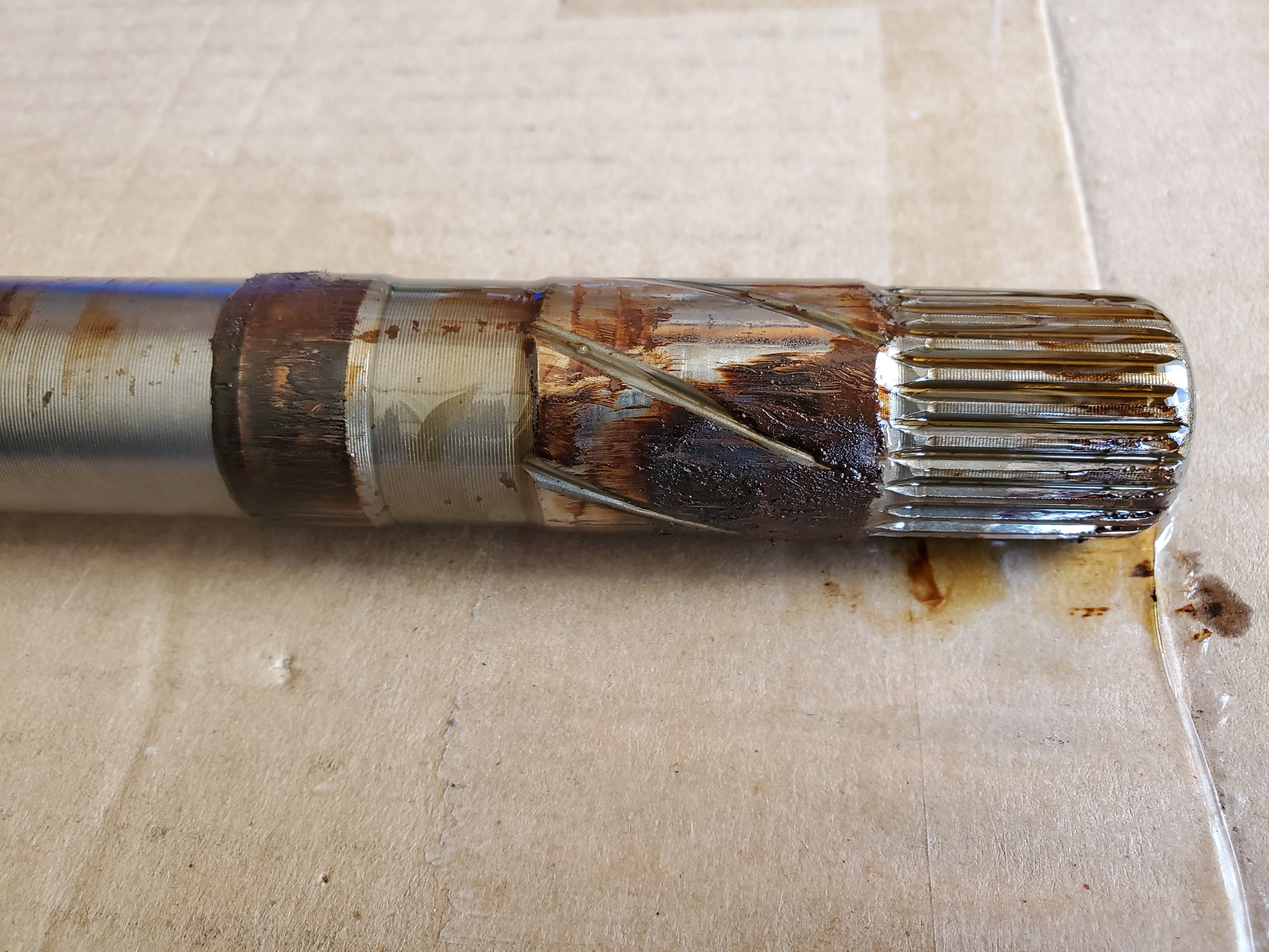

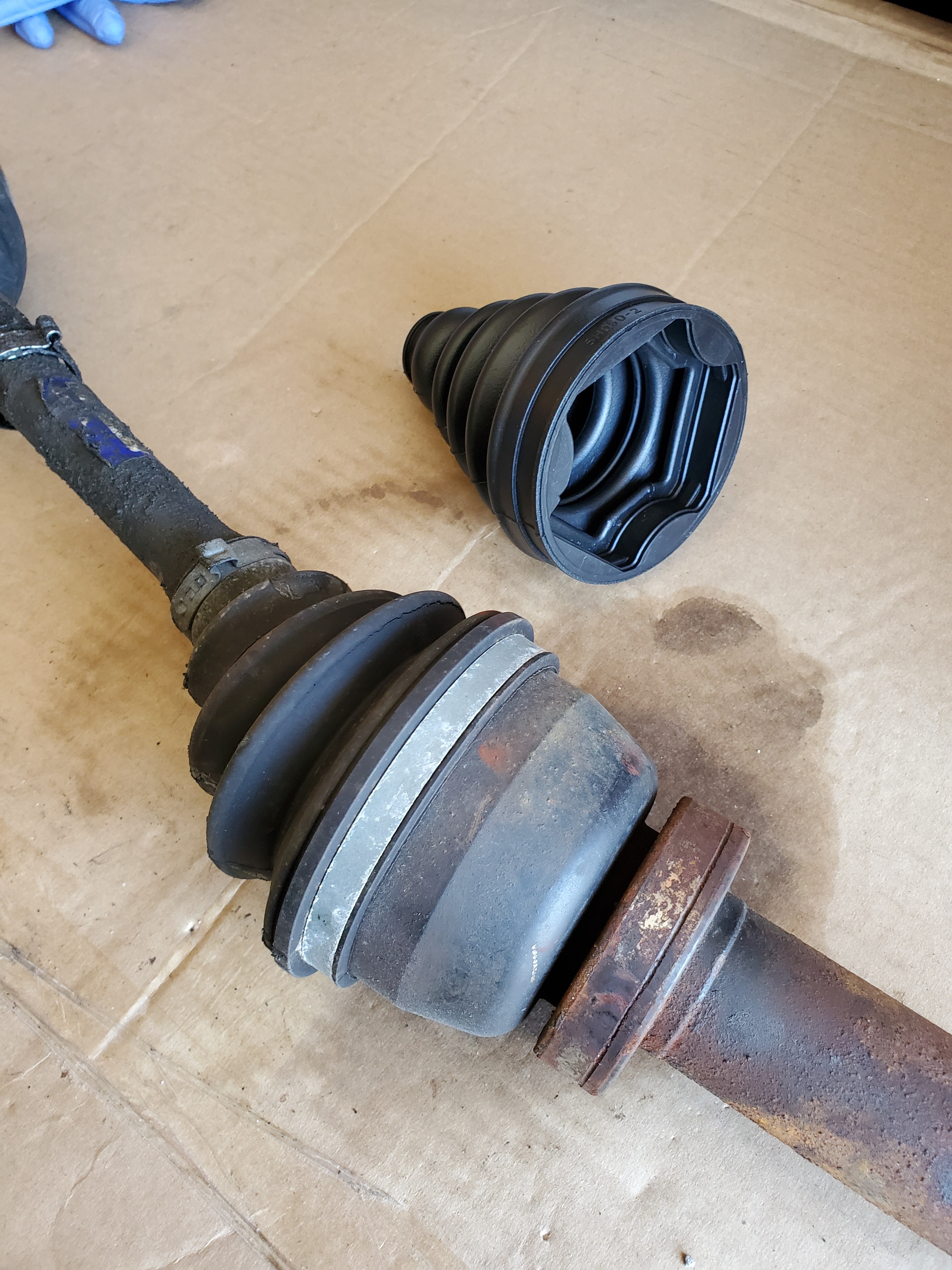

Quick question to anyone who has replaced the boots on their front right M66 axle. Do I have the wrong boot for the inner joint? I suspect the profile of the bell housing is circular, and not tri-lobe like the boot is in the picture below.
I pulled the axle because the outer boot pulled off. I replaced it last year with a kit from a local supplier, after a bunch of back and forth to get something that fit at least. Well, I thought it was pulling a bit tight but went with it. Turns out I was right and the boot pulled out from under the clamp and blew its grease all over the place.
Took a look at the inner boot too, and it's about done so I want to replace them both while I'm in here. Should likely hit the other side too...

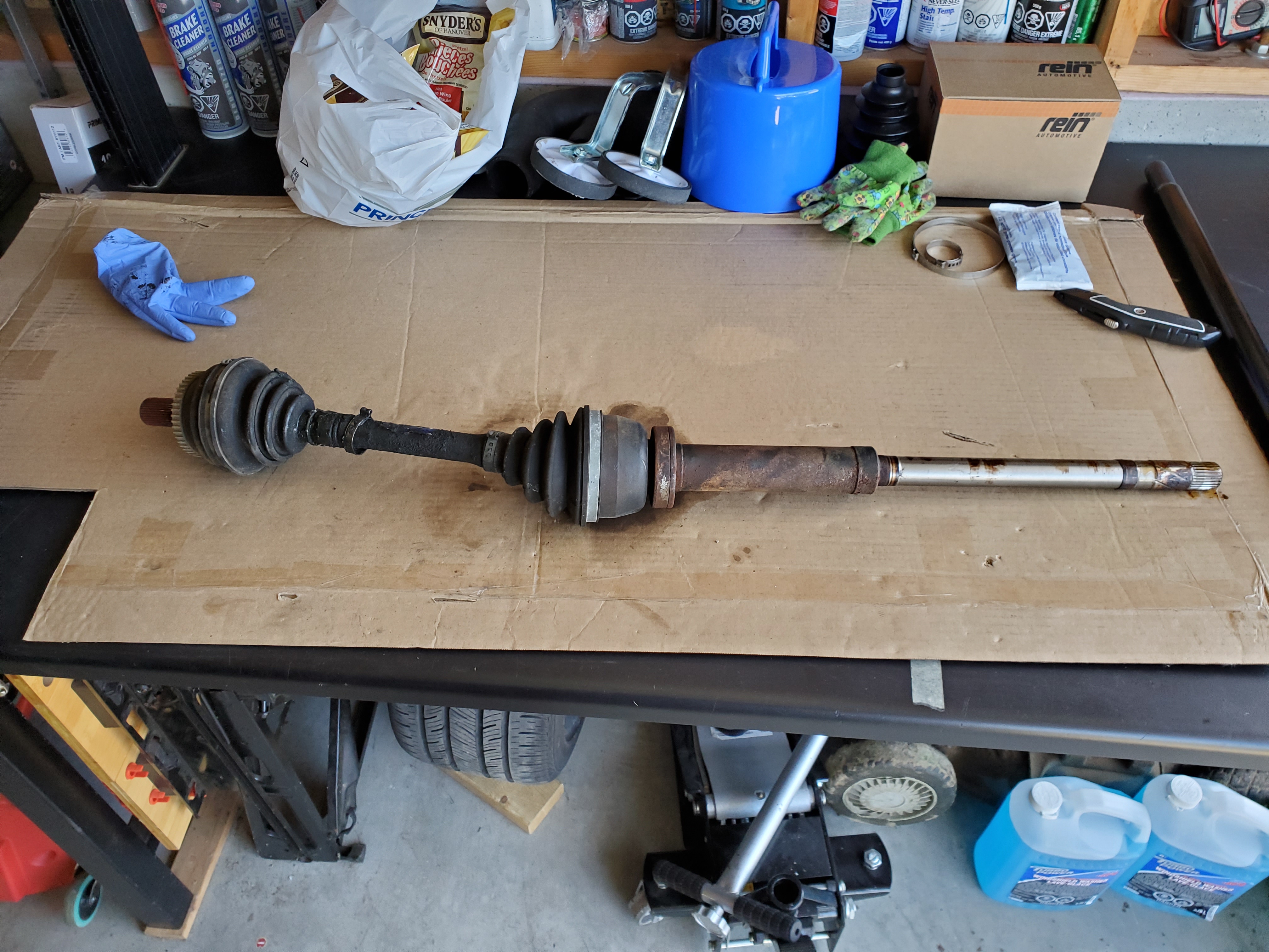

Further photos...
Axle:

Inner Boot:
Axle Spline:

Yeah wrong boot. Just buy the Volvo or GKN kit.
