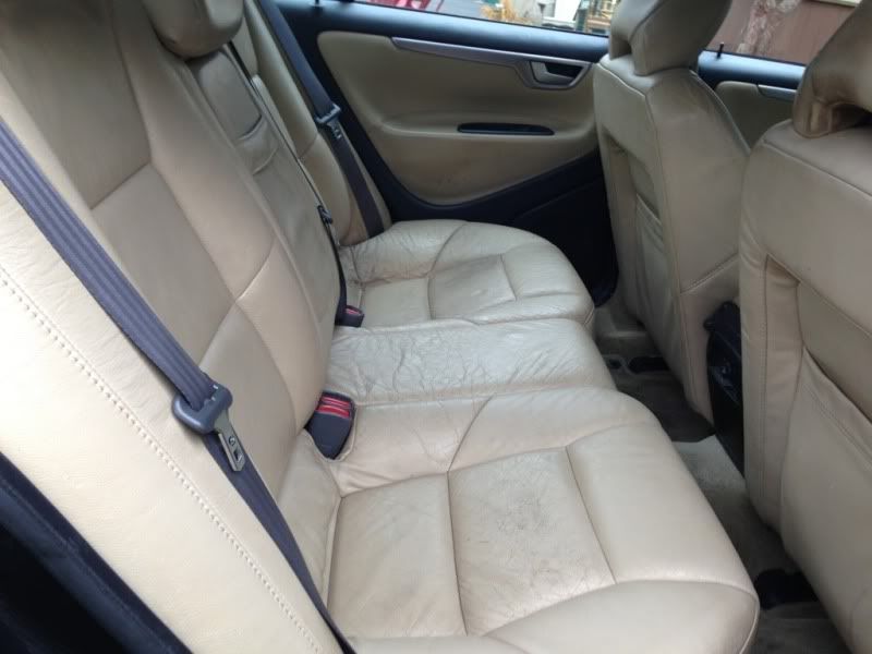

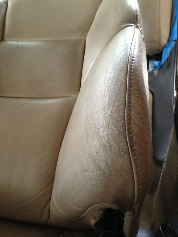

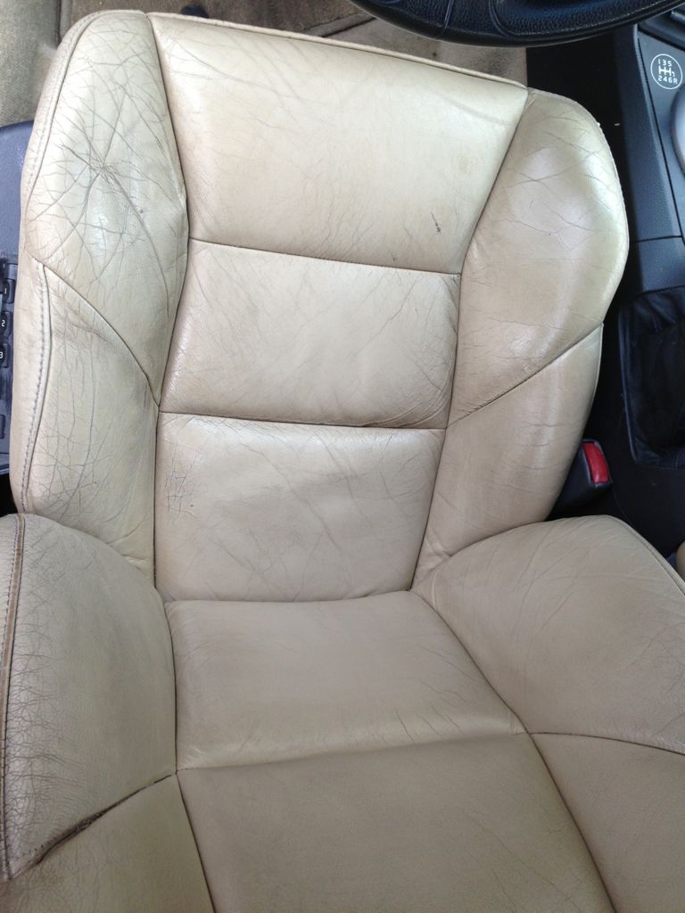

Before pictures:

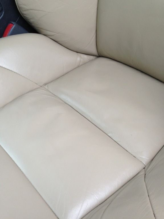

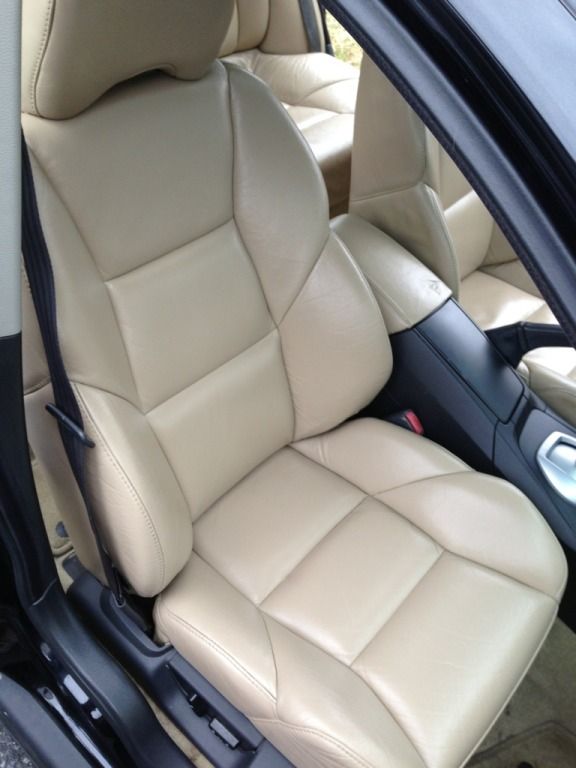

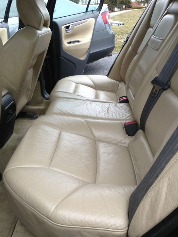

After:
I left the edge of one door panel alone to show the color difference between 8yr old Gobi and the 50/50 Vanilla/Carpezio mix. Its a shade darker but pretty darn close.
All done
