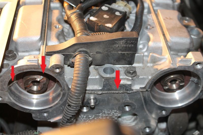

Here's a shot of the RTV on the valve cover:
Here's a (blurry) shot of what the idiot did to the end of my cam probably by using a screw driver while setting the timing. It's not clear enough to see the little broken off pieces of camshaft that were still sitting there:

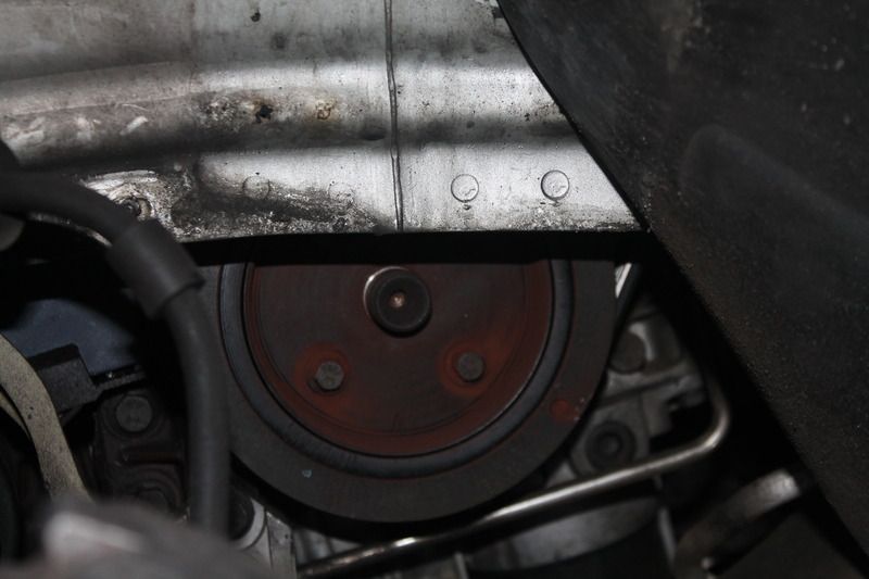

They either didn't re-install or improperly torqued the crankshaft nut. I realized it was gone while I was redoing the poor job they did on setting the timing:

Here's a (blurry) shot of what the idiot did to the end of my cam probably by using a screw driver polyethylene foamwhile setting the timing. It's not clear enough to see the little broken off pieces of camshaft that were still sitting there:
I broke off the same part of the cam shaft when inserting the cam locking tool. That didn't seem to affect anything and have not observe any issue since I reassembled the engine 14k miles ago.
