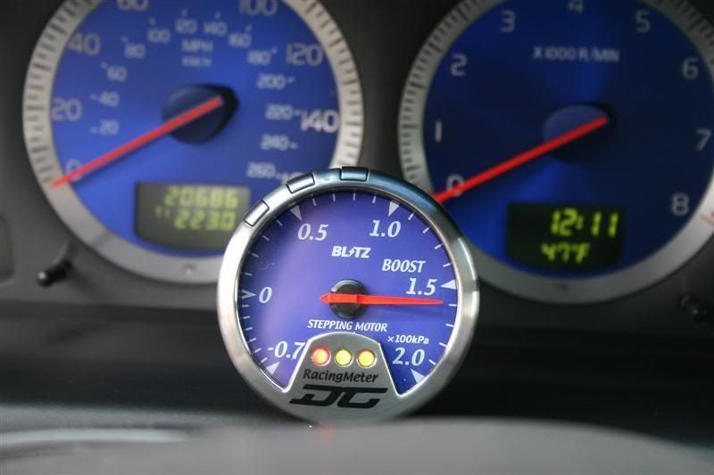

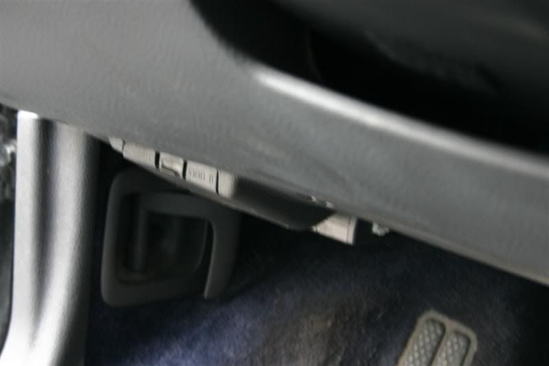

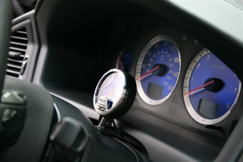

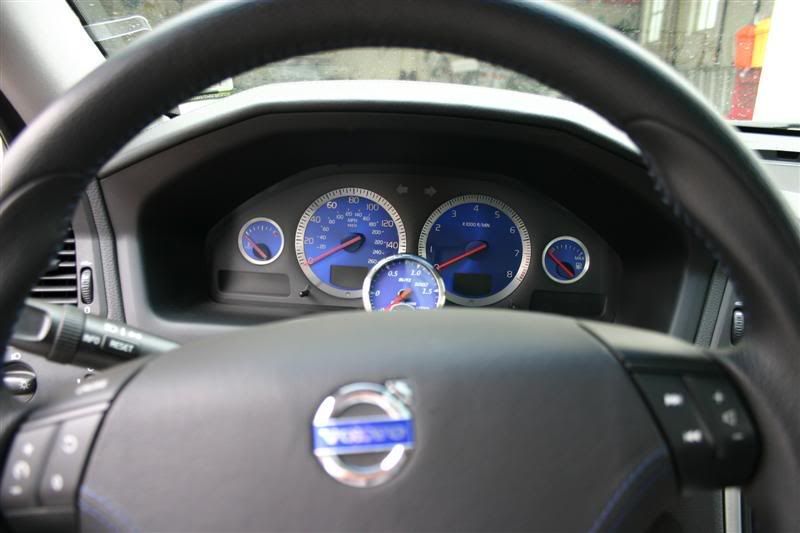

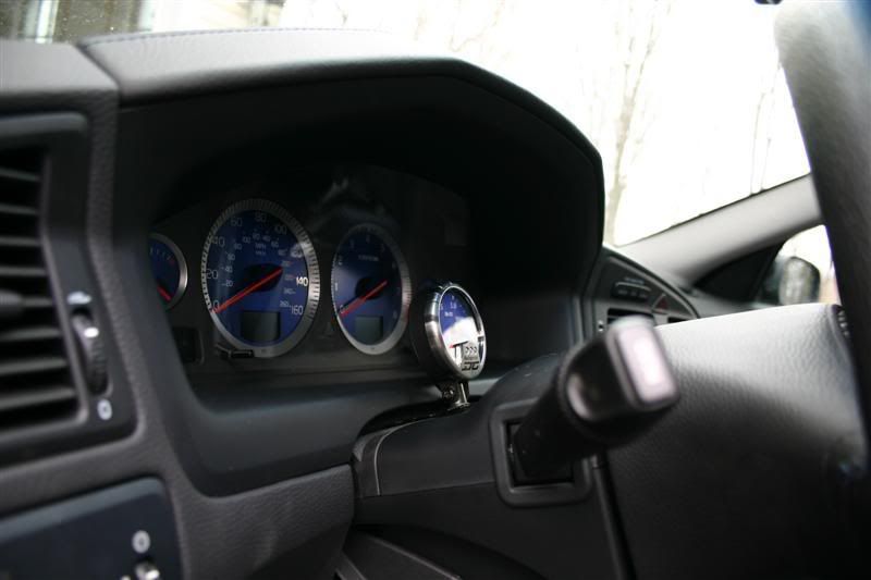

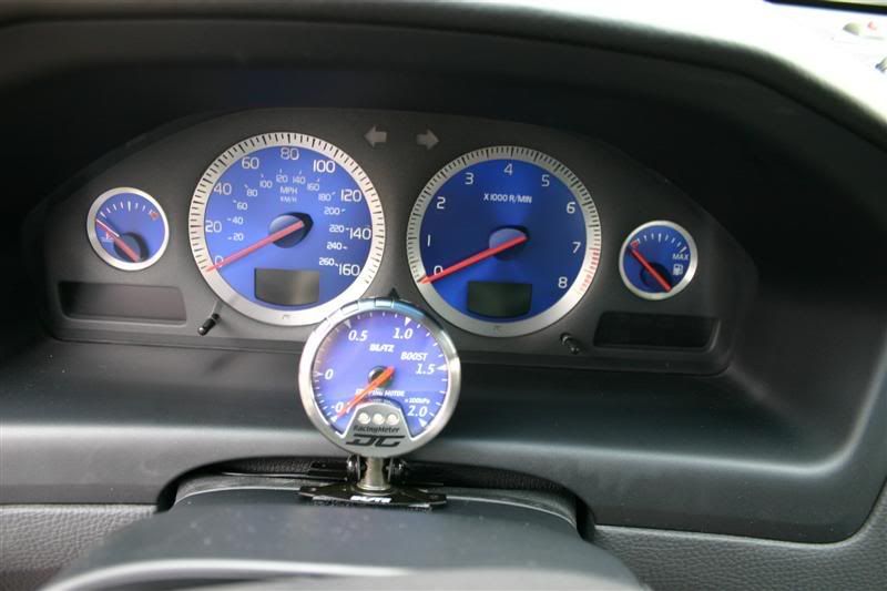

After a lot of feedback from blot (thanks!), I finally got around to installing my boost gauge in an identical location to his and here are some pics:
Live Unit nestled behind the OBD2 port:
Boost Peak Warning set at 1.6 Bar:
It works great and is a perfect match for the R gauges!

Very cool - and it doesn't obstruct anything. I like the look. Have any night shots?

I always wondered....is it strange to have a gauge that's 6" off of the focal plane of the normal gauges, but is in the same line of sight? Do your eyes hop back and forth?
Thanks - no night shots yet but will work on it! The good news is that the gauge light isn't linked to the dimmer and it has practically an infinite range of brightness which is easy to adjust.
From my position in the driver's seat, it is only a couple of inches off the plane with the factory gauges. I do not find myself inadvertently switching back and forth...
