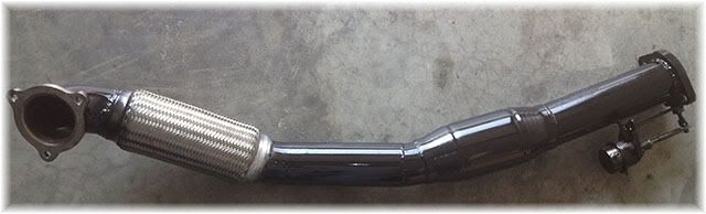

I've been toying around with this idea for a while and I couldn't bring myself to spend $400 on one of these from Sound Performance. Most people use these for a cutout (instead of electronic), but I ended up using it for exhaust quieting. I was amazed at how well it worked. The exhaust sounded completely stock when it was almost closed and as the boost built up and the valve opened, the sound shifted to its true aftermarket tone.
The internal spring of this wastegate actuator was pretty stiff and the valve wasn't fully open until 20psi, so I that is why you see a compression spring around the rod to lower the PSI limit. I am going to switch to an actuator with a 7psi spring and it should eliminate the need for that additional spring. I ran into an issue with ground clearance, so I need to revamp mounting for the actuator. And now since it works, I can make it look pretty. :)

But doesn't that mean you're adding restriction @ low pressure and thereby reducing fuel economy?
Not at all. When you are in cruising mode, the throttle is barely open and you are therefore flowing very little volume. As the load increase (throttle opens), flow increases, and the cutout opens. The valve isn't fully closed at cruising speeds. It's adjustable, but I had it set somewhere around 30 degrees...just enough to keep the exhaust quiet. Think of it this way. When you are driving light on the throttle, it doesn't matter if you have a 2" straight pipe or 3" straight pipe. Both will exceed the requirements of what is needed.
Matt, isn't there an issue with these types of things developing leaks after time? Idk I thought I read somewhere that from the constant opening/closing plus heat that the seal when closed fails over time. If this is true, I guess it would be a non issue if you designed it so it was never allowed to fully close
Sent from my HTC Dream
Tony, I haven't actually seen that. I know some people that run the electronic ones for very long periods of time without problems. This is just like the electronic one, but without the motor. When using it in the exhaust stream, as I designed, it should never be closed all the time. During my first test, I had it closed too far, and it wouldn't build any boost at all. Whoops!
For the primary use as a cutout, sealing is 100% critical and I need to look into that more for sure.
I just wanted to post my initial success even though it looks hideous. :)
