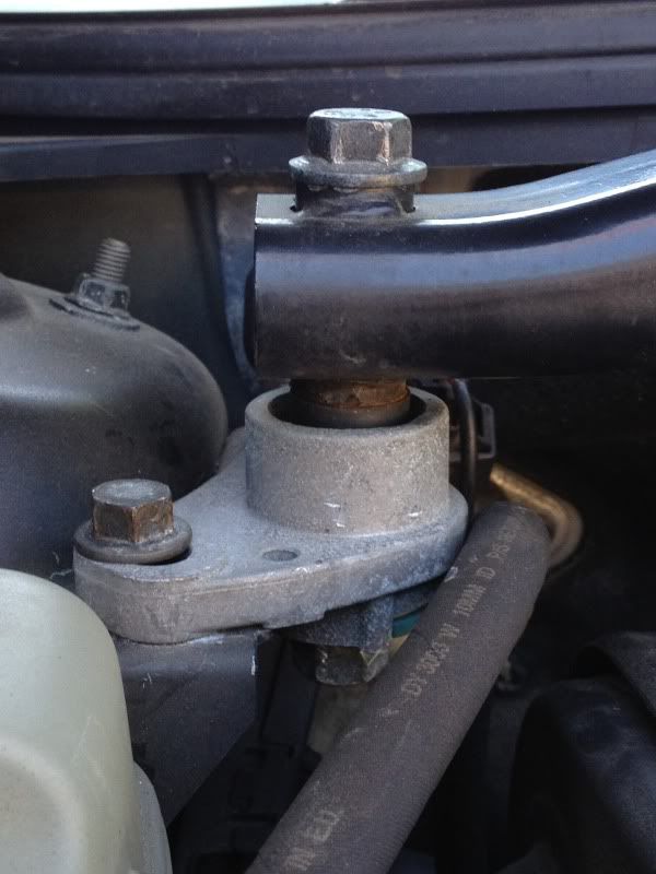

I am looking for instalation instructions or a picture of properly installled strut bar mounts on a 2004 S60 2.5T AWD.
Here is what is currently on my car and want to be sure they are not upside down.
Thanks for any help.

Yours are definitely upside down. OP

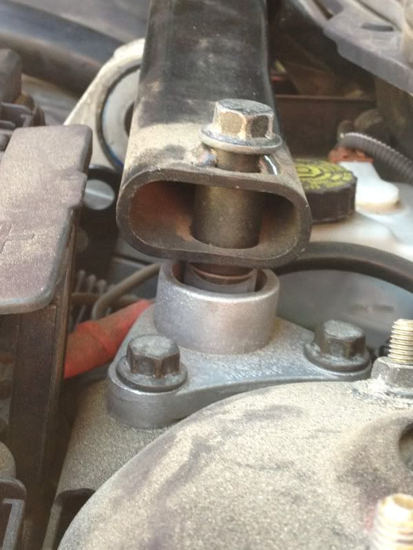

Here's a picture of mine shown under the VST bar.

Thanks for the reply. That would answer the rattling issues I have been having. Maybe I will send the new ones back after I flip the old ones.
Thanks again!

Maybe they have a purpose in doing this
No, this happens when people take it off and put it on upside. end story.
