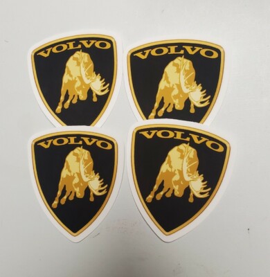

Next, I need to find a set of moose center caps in 2 1/8" size...

Wow those wheels look awesome! Thanks for posting the pics and write up. I concur about the center caps. At the least you could cut some Moose stickers, though hope you find the right center caps.
