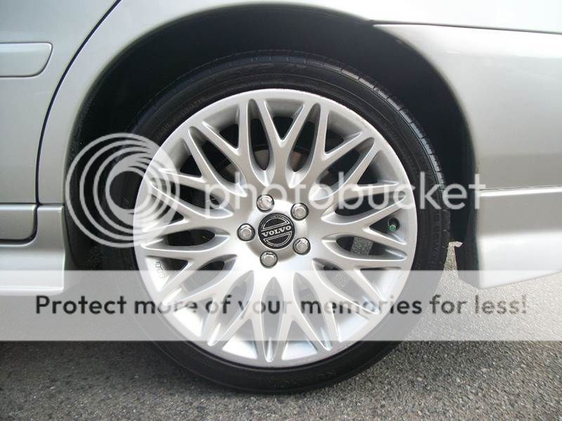

I have just bought aS60 T5 with these wheels and was wondering if the R brembos will clear or need spacers. It looks like they may need a spacer but didn't know if anyone has attemped to use these and knows for sure. They are 18" wheels. Thanks. I tried in the s60 forum but no response. I figured the R forum may have more input.
407 Posts
I'm just eyeballing and based off of a few friends' bbs wheels you probably will need at minimum 10mm spacers.
39 Posts
Been there, done that. 10mm spacers required - which is an absolute minimum. Fronts with 10mm spacers clear the calipers by less than 0,5mm.
39 Posts
To illustrate the point - this is with 10mm spacers:
2,621 Posts
So 10mm it is. Thanks for the info. Now if I can find some reasonably priced spacers and a nice set of calipers, I'll be in business.
