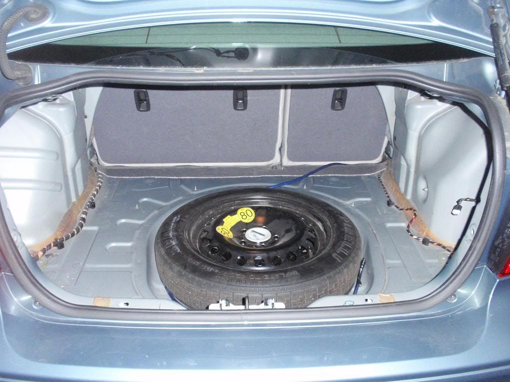

Sub box and amp plus 20lb of dynamat and all the factory junk:
