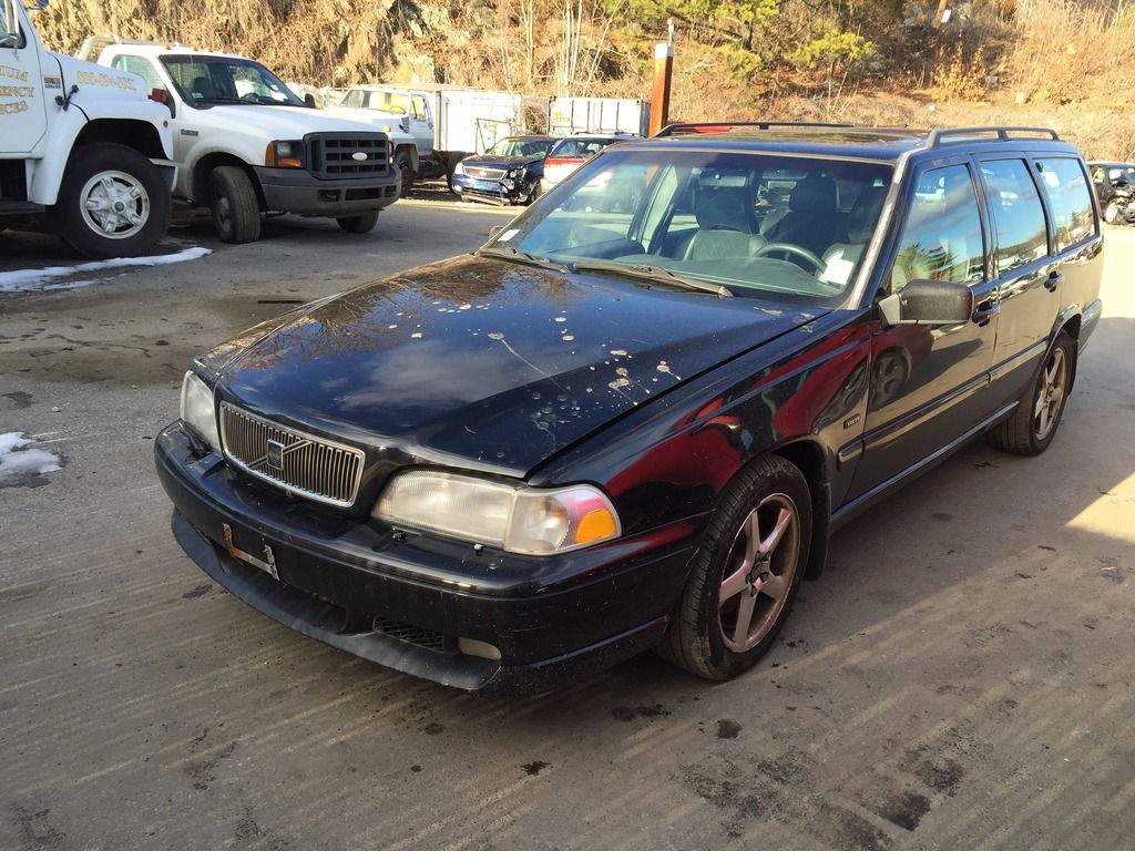

new here, i have had my share of volvos in the past. 87 245, 94 850 sedan and 97 850 turbo wagon (rest in pieces) I stumbled across something i just can't leave behind. i work part time at a salvage yard. last weekend i was walking the yard and looked in the new arrival area. that is where i saw a v70, but it caught my eye on the way past with extra attention. went to check it out on the way back. yep big ole R.
car is in fair condition, 2 owners 230k. it has brand new brakes all around so new the rotors haven't even rusted yet. at least 2 new tires. and i see some hoses and stuff new under the hood. it came it with an "engine problem" after starting it (which it did just fine) and driving it out of the yard (also just fine no noises etc) and tinkering for a while it started blowing steam out the coolant tank. so i am going with a popped headgasket. the car didn't overheat although it ticked up some and the light was on. crankcase oil is clean and full! looks to be leaking into the cooling system :/ so long ramble short. i can back into this thing for basically no money. always wanted an R and have tried to buy multiple over the years. it fell in my lap and i feel with some TLC can be a nice ride again. my main question is what to look for with this headgasket issue. is it a straight forward thing or is there the potential for some underlying problems. my sedan blew the gasket at about 250k and i would up just driving it on 4 cylinders for a few weeks and parting it out so i never really dug into one. any other things on this car to look for as i have never owned an R or an AWD volvo. thanks!

My guess is a coolant hose burst and it overheated. The previous owner had some hoses replaced and became discouraged when the blown head gasket became obvious.

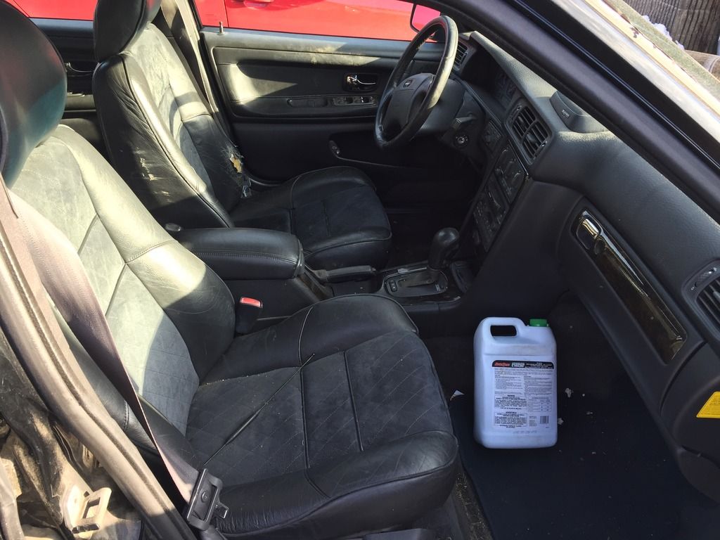

The car looks clean! How's the interior? The driver's seat skin is replaceable. Is the propshaft (driveshaft) still in place?
There are writeups and videos on replacing the headgasket. If you're able and inclined I'd say you just got lucky.

Is that black wood dash trim or does it look like marble? The marble is super rare.
That looks like a very saveable car, go nuts man. What year is it? If it's a 2000 the transmission is rare and expensive to replace. Also check to see if it has a driveshaft, because lots of people remove it when it goes bad instead of fixing it. The retail price of the driveshaft alone is over $900 but colorado driveshaft has cheaper options and it's not hard to put back in.
The only risk with the head gasket is that the head might be warped and need machine work. If you want to keep the car, I'd buy a reman head and just plan on swapping it right from the start so there's no mystery.

That's just plain old wood trim, nothing special.

While it looks totally save-able to me, you have to question if it's really worth the effort. It's going to cost a lot of money to rebuild no matter what, and generally, the P80 cars are at about the bottom of their price curve right now. Even R's are cheap. There was a good one listed here for months with a lot fewer miles than this one, clean, with a lot of maintenance work done, that wasn't selling at like $3500. You couldn't get this one close to that condition for $3500, even if you got it for free.
4,477 Posts
Yeah it's not really worth it. Even if you get it for free and do all the work yourself, you're still gunna spend an easy $1,500 (probably more) between head stuff and radiator, PCV, timing components, seals, all that jazz. And then it's just running, still have other maintenance that a 230k VR needs, like suspension and AWD stuff. Rear shocks alone are $300 a pop. I would buy a decent sorted one that you can get under $5,000 and you'll be way ahead of it. Don't worry if a project is what you want, even a well sorted one needs work all the time. I have had mine for over 3 years and over 15k later I'm still working on it every other week.

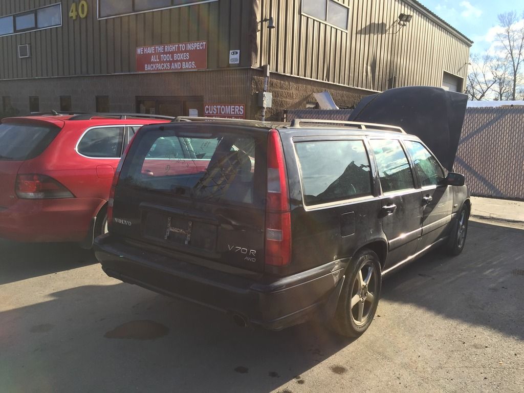

Poked my head under it last night.. Has new factory rear suspension parts with the stickers still on them BUT driveshaft is gone :(
131 Posts
With no rear driveshaft and with a head gasket issue, I'm in the "grab it - part it - crush it" camp if you can acquire it for a few hundred $$ and have the space / resources to do the part-out.
