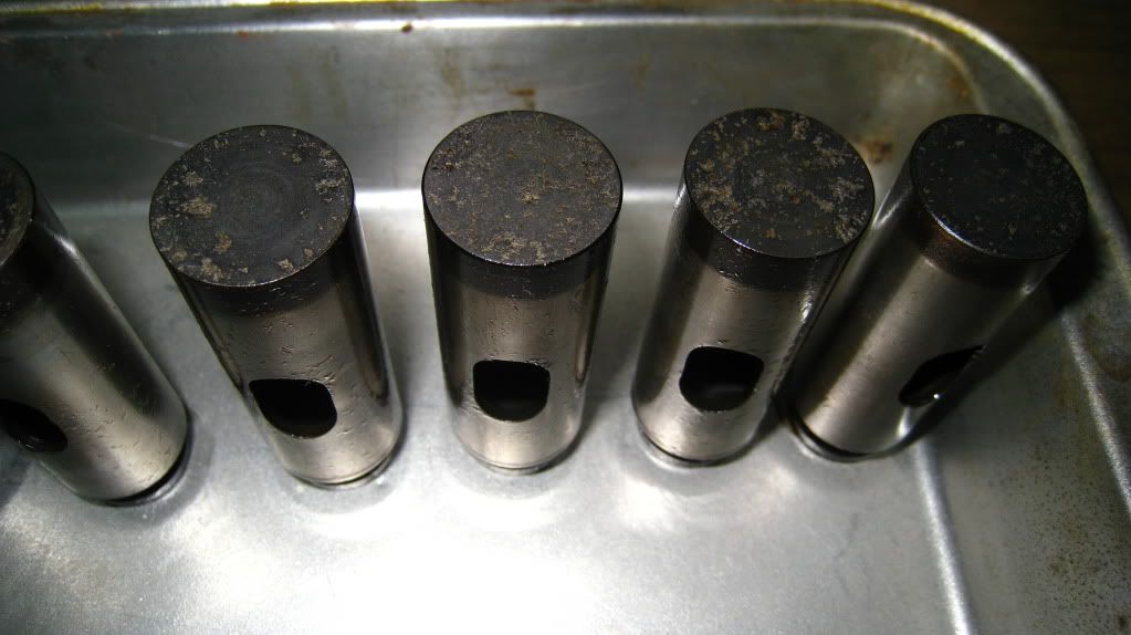

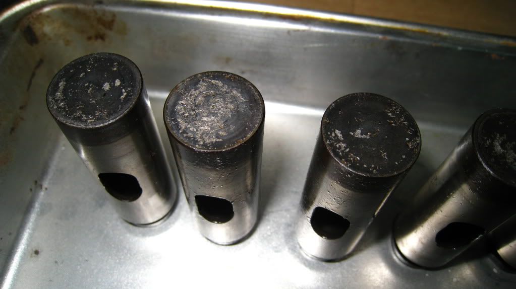

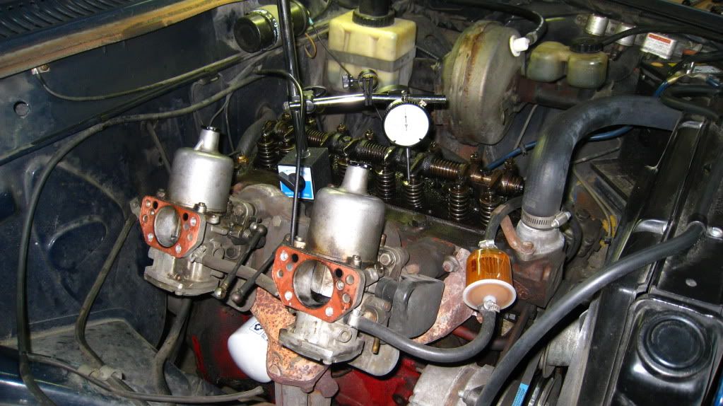

When I adjusted the valves during the tune up, I could tell by eye that not all the valves were opening with the same lift, so decided to measure these before removing the head. Results were as expected, several, including the #1 exhaust valve were opening less than .200 – camshaft/lifters were added to shopping list.

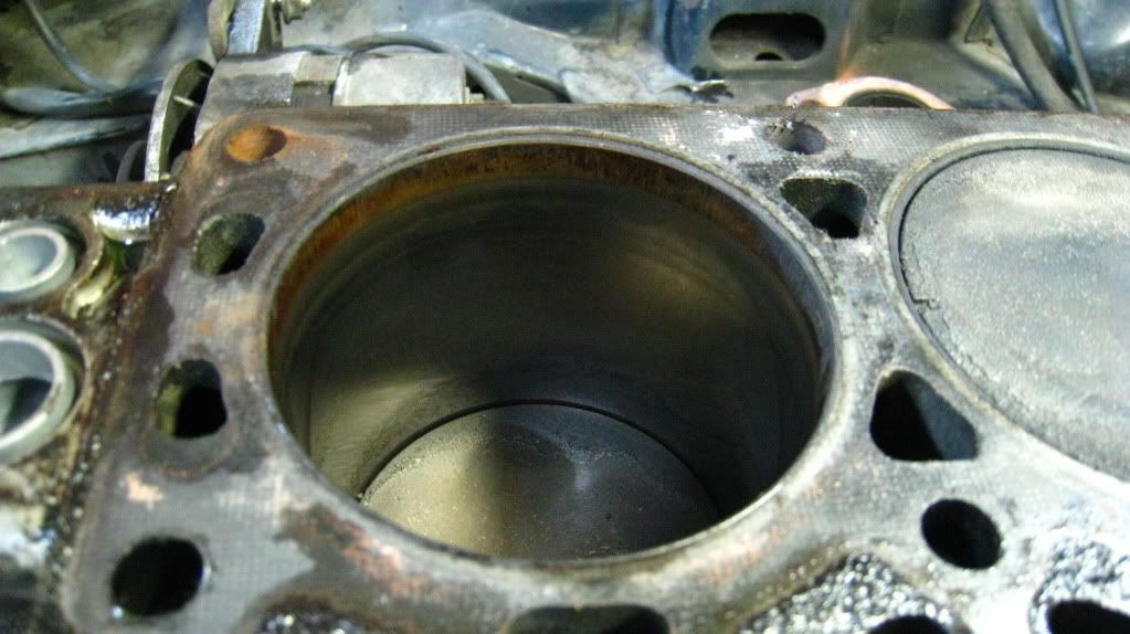

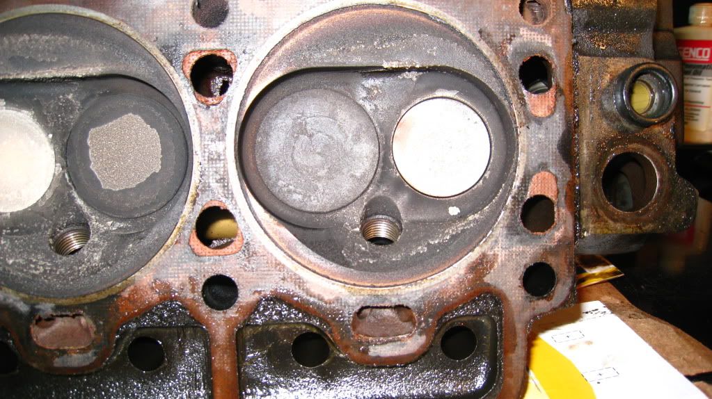

I went ahead and pulled the head with the engine in the car just to see what I might be in for. What I found was a very burnt and receded #1 exhaust valve which was probably leaking all the “bang” from that cylinder into the exhaust. (Now I know why the exhaust had a funny sound to it) Also, although the cylinders were very smooth, there was almost no lip at the top.
It was at this time that I debated doing the (uncomfortable) cam install with the engine in (mostly in) the car or just remove it. After pulling a few lifters out for inspection and imagining what kind of metal particles have caused this wear and cycled through the engine, I was running for the engine hoist!

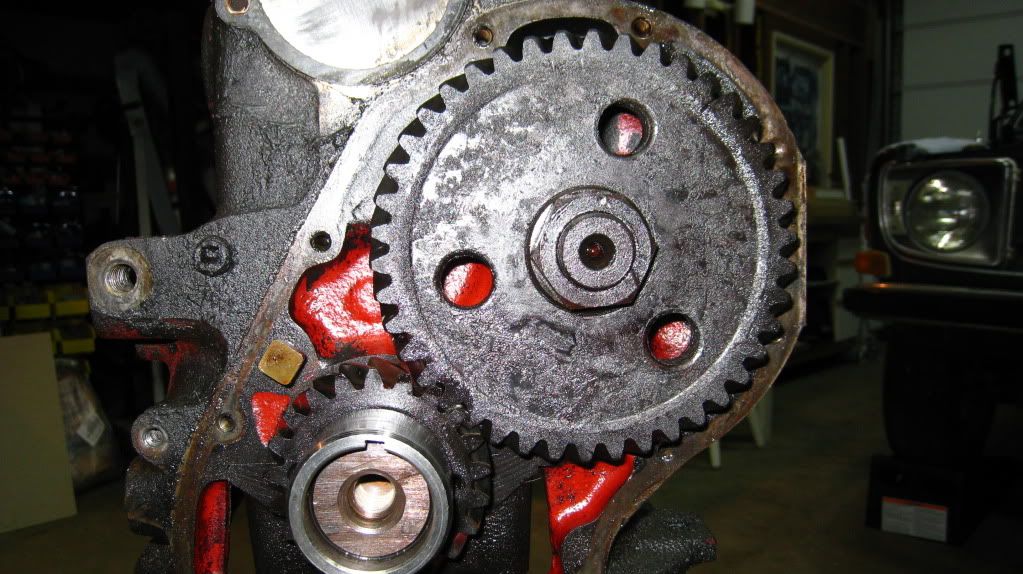

What I expected was to have the timing marks aligned on the gears, #1 piston at TDC AND the rotor position at firing hole #1. What I got was the rotor 180 degrees from #1, with the marks aligned or the opposite, camshaft gear 180 degrees out with the rotor at #1. Here is the latter.
I am still miffed by this, could the engine even run at all like this? I know a SBC will run like this, albeit very poorly.

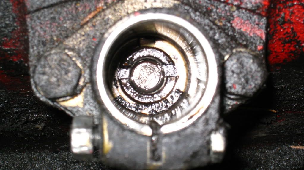

I went ahead and pulled the distributor out with the timing marks aligned, and snapped a (not so great) pic of the shaft orientation.

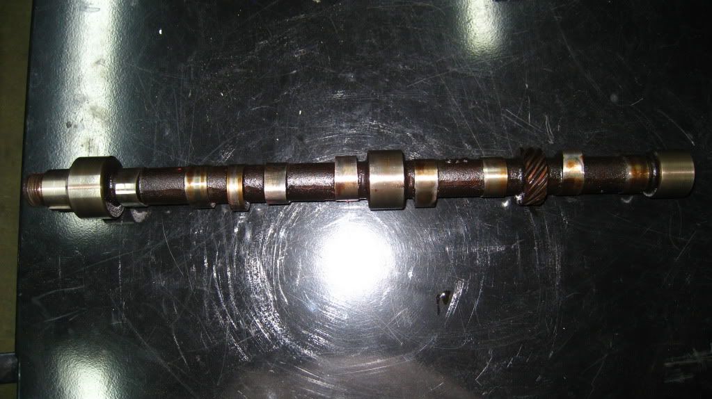

Off came the gear, and out the cam. – Added cam bearings to the shopping list.

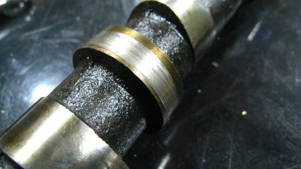

Here is where some of the axial movement of the cam is, the brass retaining plate. About a .010 deep groove.
I think I am going to mount the cam on the shop wall and give it a purple heart. (Also, see the wear on the fuel pump lobe – fuel pump was added to the shopping list accordingly)

If you turned the crankshaft 360° the timing marks would line up and the distributor would be pretty close. And you can put the distributor in almost any old way and if you put the wires on correctly for the orientation, and then time it properly, it will run fine.
Can you give us the motor type number, on the driver's side of the block near the top, first 2 or maybe 4 numbers cast and the rest stamped on a rectangular boss. First 2 digits will be 49, USUALLY followed by 69 for earlier models and the next 2 digits and we can tell you how it was originally equipped.
