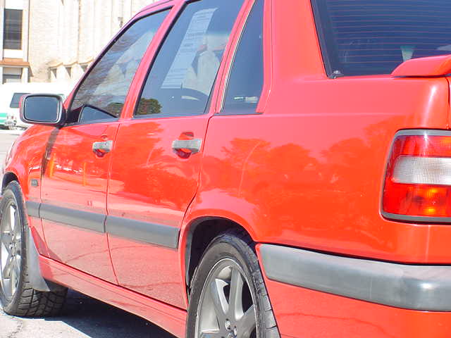

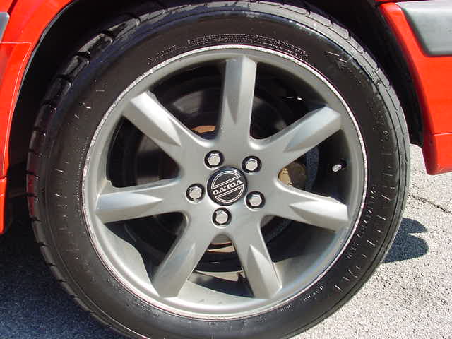

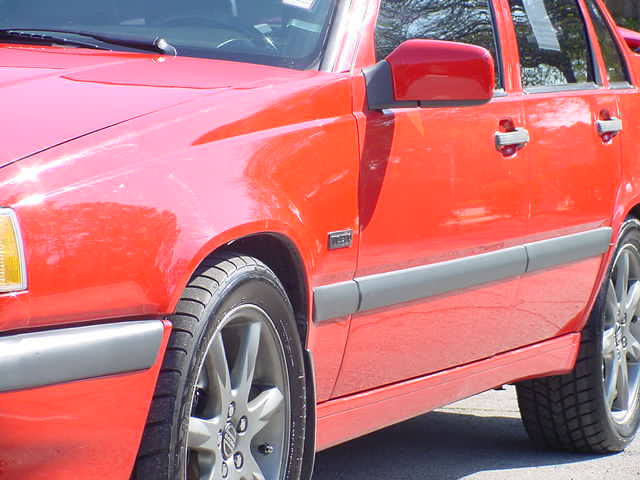

I can't read the size on the tire in the picture, but if it is 245/45/17 on an 850R, it WILL rub on turns with the stock suspension. I know 205/55/16 will rub, and those 245s would be about 0.8" taller, not to mention a lot wider. Maybe this guy only drives in straight lines?
245/35/17 or 245/40/17 might fit with some small spacers and a stiff spring/damper setup. The fenders may also need to be trimmed/rolled/pulled depending on the suspension and wheel offset.

Looks like 245/45/?17
quote:
LOL
One thing that could be, is that measurements vary. Some tire makers take the width measurement and entire width of tread, that includes a little that rolls over on to the side.

quote:
Originally posted by NoahK24:
CAn't the 850's run 18 inch tires with no rub at all?
The issue here is the extreme width of a 245 tire. An 850 should be able to fit 18" tires, but it's a combination of height and width that determine whether or not a tire rubs (assuming the offset is constant). A 215/40/18 is just barely shorter than a 205/55/16 (which will rub), so an 18" tire may not rub or if it does, it would be minor.
