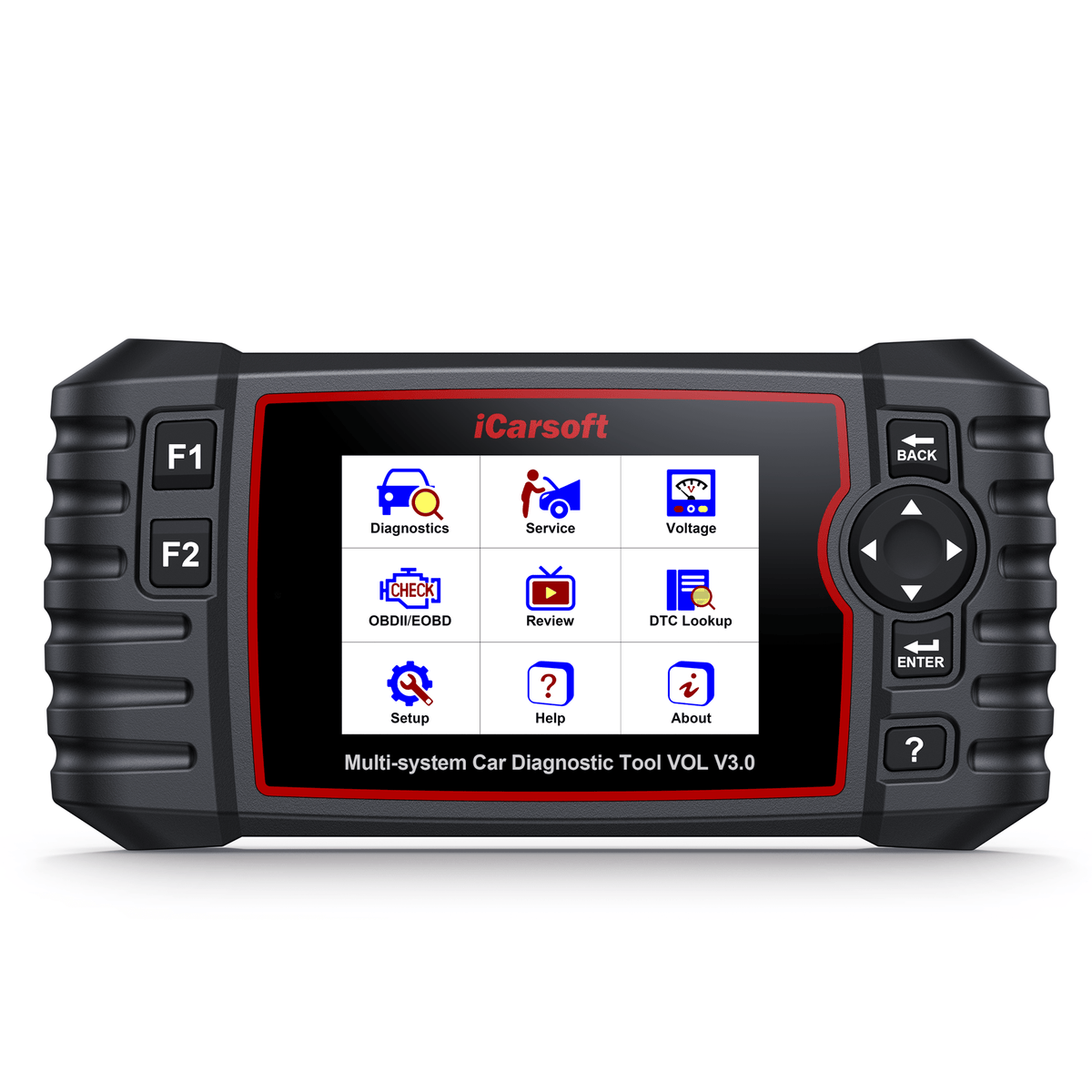

While you all are here, what are your thoughts on which (if any) OBD2 scanner I should get? I recognize vida/dice is the gold standard, but I don't have that and I'm not the best mechanic as I can only do simple things like swap out a battery, change a headlight bulb, etc. I'm not looking for anything super fancy, just something I can use to check if my emissions system is ready for inspection. After looking through the forum here, I've narrowed to these three as it looks like they should be compatible with Volvo:
Does anyone here have experience with these? Or should I just get the set up to enable VDASH from D5T5? Thanks so much for your input!
#22 ·
I have an earlier version of the Icarsoft (VOL2) and it works fine. You can usually save a few bucks by getting it at Amazon.
Folks like the Foxwell one too.
I wouldn't spend the money though to just check emissions testing readiness - just drive the car normally for a couple of weeks and you should be good.
