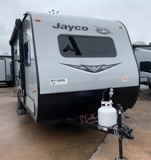

New poster, but a longtime Volvo owner. We moved out west a couple of years ago and are thinking about a smaller travel trailer that we'd tow with our XC90. We also have an older XC60, but wouldn't even try.
We're looking at this guy, which Camping World will move up to Oregon for us:
The spec sheet says its dry weight is 2,945 LBS and our XC90 is max tow is 5,000lbs/500lbs tongue weight.
Based on what i've read elsewhere, this seems doable. Should I be concerned? Should I pull the trigger?

No reason you can't pull it based on the specs of the trailer and the specs on your XC90 - you correctly mentioned the dry weight, which is important to consider before adding fluids, food, gear, etc.
At the weight of the travel trailer, it's probably a good idea to look into a trailer brake setup on your car, and look into a weight distributing hitch as well. Both of these will make it easier to tow and will be less taxing on the XC90, and most camper dealerships can help set them up specifically for your car. If it's over short distances, neither are needed, but definitely recommended. Cross-country trip - absolutely. Just make sure you get a ball mount that is correctly rated and the right size ball. Great looking camper!

@mjpierce11 - You'll be fine! What you're considering getting is totally within its design capability. XC90 are excellent tow vehicles with extra safety built in (Tow Stability Assist) when you use the Volvo tow module and harness.
The Jayco likely has e-brakes and in addition to getting the Volvo kit you may want to get the Prodigy RF brake controller. Given the weight it'll be ok without but better with one. When we summited a pass over 10k feet and >15% grade the enclosed cargo trailer we had at the time for that trip didn't brakes and was at its 3500lbs capacity. As with any good mountain driving manually shifting not only makes it more enjoyable but also safer. At viewing look out we encountered a genius in a GMC 3/4 ton (Silverado) pulling his Harley trying to cool his brakes (pretty sure he was 'Merican) - they were smoking, the brakes - and his solution was to add more brake fluid. I made sure to let him leave first. I didn't want to become his e-brake.
