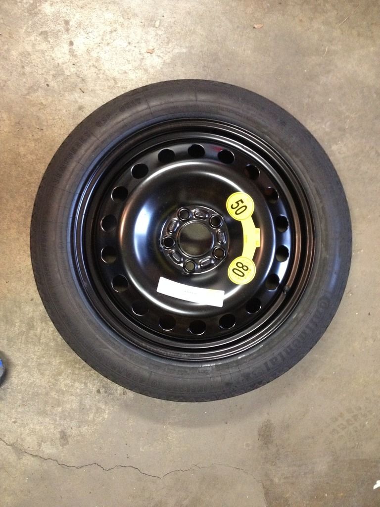

While researching the V60 RD I learned the car comes with fix-a-flat and an inflator rather than an actual spare.
Not being super comfortable with this, I knew a spare kit would be in short order once I purchased.
I did some reading here on swedespeed and found a few threads on the topic:
http://forums.swedespeed.com/showthread.php?223972-V60CC-spare-tire-storage&highlight=v60+spare+tire
After reviewing my options I decided to purchase just the spare rather than the full liner/kit. The best price I found for the spare was $220 shipped to my door. As mentioned in other threads, the part number is 31317980.
Here's what I did:
1) I Bought this

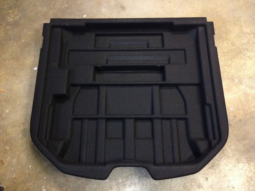

2) Did a test fit with the jack and accessories removed
3) That's not gonna work
4) Mark it up

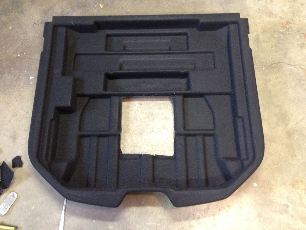

5) Start some test cuts - I used tin snips and a small hacksaw - will lose some of the storage but not all

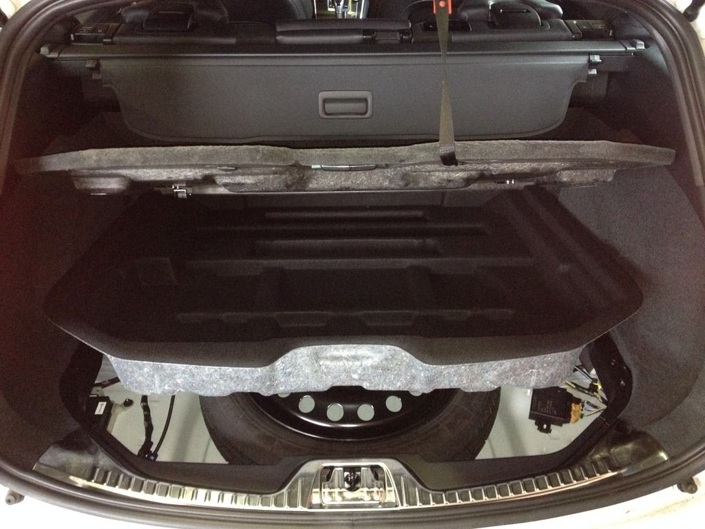

6) Finished product - Jack, lug wrench, and tow hook are wrapped up in a towel underneath the spare
7) Load floor closes flush, grocery bag holder intact and functional

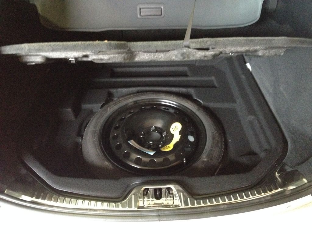

Very satisfied with the final product, although I wish it had come this way straight from the factory. :beer:
Certainly cheaper than the $695 spare tire kit and you don't lose the grocery bag holder.

I trimmed the plastic tray such that it fits tightly around the wheel. The tray actually has to come out before the wheel can be removed. The wheel tucks nicely against the rear of the trunk (bumper edge, kind of underneath the striker for the trunk latch) for support as well.
No squeaks or rattles yet but if I start to hear any I can add some padding as needed.
