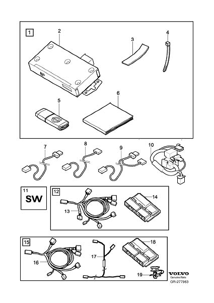

The volvo part looks like its $90 and would entail disassembling a lot of the console. Anyone ever try a DIY re-solder of the end of a USB cable? Probably would entail the same amount of disassembly. Anyone every try to replace this? I can't seem to find instructions - but I am guessing the volvo part runs from the socket in the armrest and runs into the center console?
its either part 7,8, or 9

That part is Number 30775252, it's a simple and direct replacement for the old usb connector unit and costs less than 20.00 dollars. I had to do the repair myself
