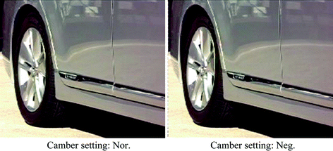

One of the main issues is that the rear right wheel is a bit inclined inwards at top (not too much, like in the image below), as with camber and is a bit "toed in" (sorry if it sounds funny, I'm new to all these terms). Mechanics around don't seem to know what caused it, because it all looks fine underneath. Some of them say it's a problem often found in the p1 platform (Ford Focus & Mazda 3 can too have this problem)
Any guesses how can I get it fixed or what else should be checked?
