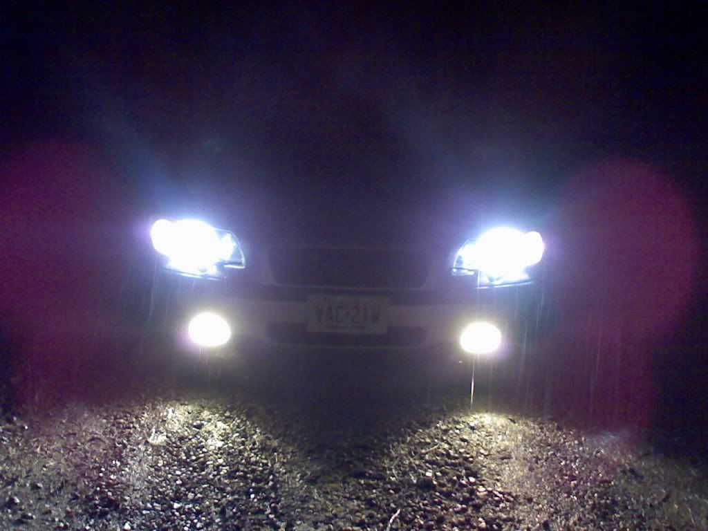

Mine don't come on with the car, only when I flip the switch. Works fine for me and I like the fact that I didn't have to pay the stealership. Plus you get a certain satisfaction doing it yourself.
Fogs and Lows-
