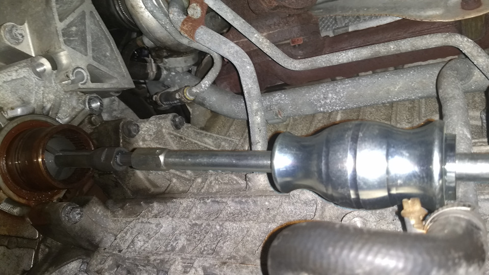

      I appreciate the feedback. I have been reading threads and getting that sleeve out looks like a 10 hour fight.
      It took me maybe 5 minutes with this kit: https://www.amazon.com/Bearing-Puller-Internal-Extractor-Remove/dp/B017XDLDDY
      Taking out passenger axle can be challenging the first time, however it is possible to take it out without fully disassembling the strut/wheel hub.
      Get a long torx set for the propeller shaft bolt, and a few extensions.
      I would not say it is super-hard. Definitely not 10 hours, maybe 2, including consuming couple of beers.
      Not concerned with the axle shaft, I've done plenty. And luckily I have a lift. I will definitely be looking at getting a tool like this before I tear into the car - thanks for the link.
