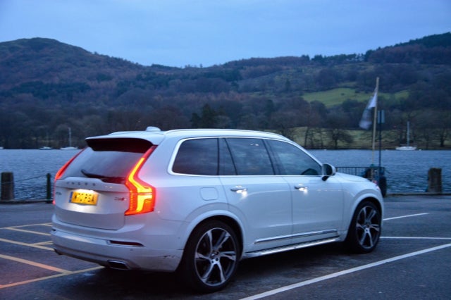

Currently riding on the 275/35/22 which is what came with the car. Picture attached. Question is if i was to move to 285/40/22 would that cause an issue technically? All the techs out there can you confirm? I also have the option to go for 285/35 with the 22 inch rims.
40 profile will increase your wheel circumference and you will need to recalibrate the speedometer at the dealer. Officially Volvo will probably tell you that they can't guarantee wider and higher profile will not rub on smth inside the arch as they have nothing to gain from it but everything to lose if you do damage it - so it will need to be a friendly tech who wheel try and check it for you. In Europe deviation from standard tyre spec can be grounds to invalidate your insurance. With extra width you will have extra 5mm stepping out of the arch and throwing mud and stones back at the car. Just seems like a lot of headache and question marks. I'd just match the tyres.
I personally would go wider 285/35 not taller 40. You will be just fine with few mm more width plus looks better too ;-) Plus more tire choices with 285/35 and cheaper too!
Technically 285/35R22 is actually closer to the stock 275/45R20's than the 275/35R22's (+0.4% vs. -0.6%) so well within mileage/size adjustment limits. 285/40 may or may not fit but will definitely require recalibration as it's over 4% larger. You'd probably need to do a bunch of measurements on clearance of the current tires (loaded, full turn, incline) around wheel wells, fenders, internal suspension and nuts/bolts.
Here's a great tool (I pre-fitted a few of my guesses though I have no clue what the offset on those wheels is and I assume they're 9.5" wide w/ an offset of 45)
http://www.wheel-size.com/calc/?whe...T45&wheel2=285-40-22X9.5ET45&wheel3=285-35-22X10ET60&fcl=25mm&wcl=25mm&scl=25mm
The key parts is the clearance at the bottom. On the same 9.5/45 rim, you'd lose 5mm to the fender and 5mm to the wheel well (thanks to extra 10mm in width) and lose 18mm to the wheel well or anything above the tire (extra 36mm sidewall, 18mm above and below)
Overall though I'd second brutus. 285/35 gets you a little more height, a little more width and *should* (not an official statement) fit. Plus the choices and prices in that size is the sweet spot of low profile 22" rims until you go into the full out F150 truck style tires (305/40 or 45 R22)
Also note the 18mm bump would realistically raise your car (and its center of mass) by 18mm too and definitely alter driving characteristics along with more sidewall. Softer ride, less sporty.

Thanks everyone.. And great replies.. Yes have air suspension and more inclined towards 285/35. On rise quality you do feel the bumps but to be honest I had the q7 with the same tyre profile so I am used to the feel of ten road. You will
Get used to it

To respond to the OP's question ill be swapping to a 285/35/22 the day our R-Design arrives.
I don't see an issue with it fitting and no need for re-calibration. I've up-sized on countless AWD and never had an issue besides being a MPH off when at highway speeds.

I have over the years driven on 275 and 285 and have noticed that the comfort does go up purely because with the extra width the pothole is covered and the car glides through it, meaning to say if the width was narrower the car goes into the pot hole. Regarding the noise I have not noticed much difference due to old age. And yes the tyre choices are a lot in 285/35.
One last question, do I need to recalibrate anything if I went with 285/35?
