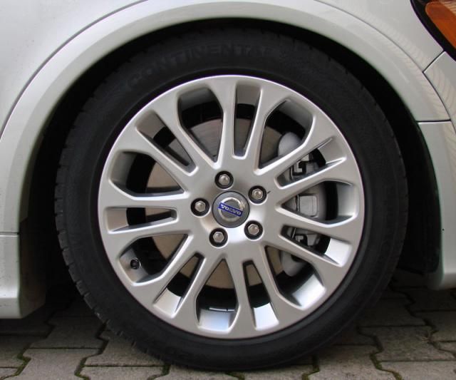

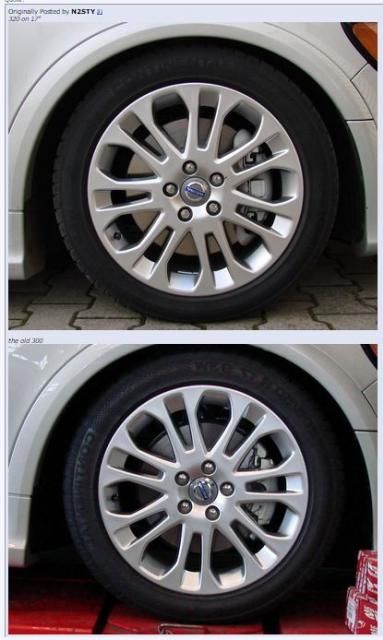

Here are some pictures.
Not my pics.
300mm
320mm
Installed.

I should have taken more pictures of the install but it was extremely simple and everyone can do it with just 2 wrenches... 15mm and a 12mm...

but I'd be careful... my 320mm standard rotor setup (V50 D4) fits just right with OEM 16" rims, but the inner weights from my aftermarket OZs rubbed. so - 16" is possible with limitations ;)

Essentially the 320mm is only slightly larger then the 300 due to the difference in calipers.
In many cases when you go from 300 to a 320mm you are increasing the overall distance from the center of the wheel to the edge of the caliper by 10mm. Now in this case my brakes were less then a finger gap from between the wheel and the caliper. This is why i wated so long to upgrade.
Once i found the pictures above which confirm that there is ample clearance with the OEM 16" wheels decided to try and see how it will fit.
I would say if I had about 10mm before I have about 4-5mm left now and the gap between the wheel weights and the caliper is about 3mm.
If you are running 16s now im 90% sure that these brakes will bolt up.
